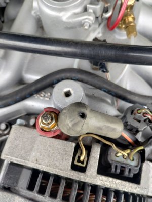

Think I found the issue.
I started noticing it happens more when I'm accelerating while turning. Like merging onto a busy road from a side street (kinda sucky time to have a car cut out on you).
Kept shaking the harness while it was running, front, back, interior, ground, power, even shook the EEC while it was running because I needed to find something. Started checking the alternator wiring. And there that was.

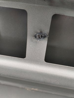

I guess I'm cutting the hood support a bit.
View attachment 12543View attachment 12544
Yeah that’ll cause some issues! I presume that’s because the SVO mounts the alt slightly higher? You can actually remove that red standoff entirely and mount the cable to the back stud on the alternator. That’s actually how it is on 94-95s
Did this today. We will see what happens.

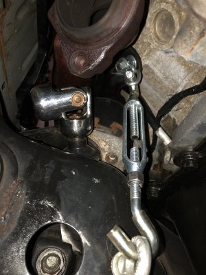

This is what I use
I bought a setup like that from Rod,the only difference being the hooks welded closed.
I got the idea from Rod and tried finding those enclosed ends but you can get this at any hardware store and in reality their rated strength far exceeds the torque any NA 4.6 could dream of making. I'e been running this for years without any sign of the ends opening up and its definitely done its job as the EGR valve (when I had it) would dent the hood bracing until I installed it. The shifter also shook less( which I kind of miss, ngl lol)
