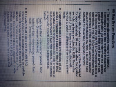

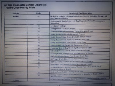

    The codes flash two numbers. If it is flashing three times each time, then you have code 3-3 triggered. I think 3-3 is the code for open circuit or high resistance on the passenger side airbag, but don't quote me on that.
    @jco1385 posted something here a while ago that had all the codes listed, but I cannot find it now.
    Never fear, there's a tech article for that. :)
