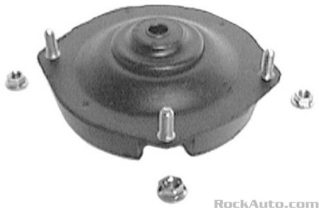

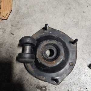

Has anyone tried the available top strut mounts on a ARC car ? The ARC mount has a 1/2' hole with a 2.5" sleeve and bushing on each side.
The regular one's look like maybe sleeve and bushings are part of the whole assembly...

What shock setup is this for?
That might be a running change as the later SCs I’ve seen with original ARC shocks use the integrated top mount like regular suspension models. Should directly fit.
