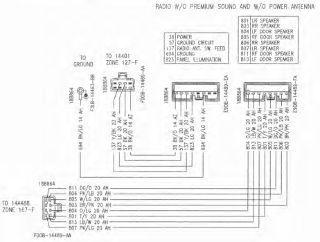

    Factory wiring is 20ga.

    I’d only run new wiring if you’re running an aftermarket amp, with headunit only though the stock wires are perfectly adequate and convenient….
    … unless your car is a premium sound/JBL car. The wiring from the stock headunit to the factory amp(or requisite bypass jumper with an aftermarket HU) is puny - think internal wires in a USB cable puny - so if you car came with the factory upgrade systems I would recommend going ahead and running wires because it really will be an upgrade. Or find a standard low end radio dash harness to swap in so you can connect the full size wires to the main body harness going to the speakers.

    The hardest part of the whole damn thing was not breaking clips on the dash, and running the 12awg wires thru the little tubes to the doors. The stock factory wiring was fine for 6 ohm speakers these came with, but most speakers are 2 ohm now. The 18awg factory wiring is too small now. Crutchfield has some good speakers that fit; but you'll never get bass out of them. a 12" sub running ~500W, and ~50 rms to the 6x8's, it will sound really good.
