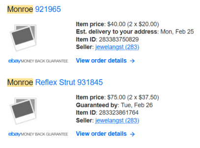

I still have a set of new old stock Reflex for the front and back. Hopefully they are still in good condition because they are probably ~20 years old now. I still have the saved search setup on eBay, none have been listed since these ones I bought in 2019 :
