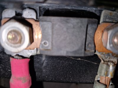

Sounds like a viable theory as well. Assuming this is the megafuse, I measured less than 0.04V potential difference between either end of the fuse and the battery positive terminal (when starting). I think that's still fine?

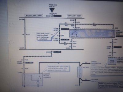

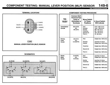

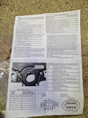

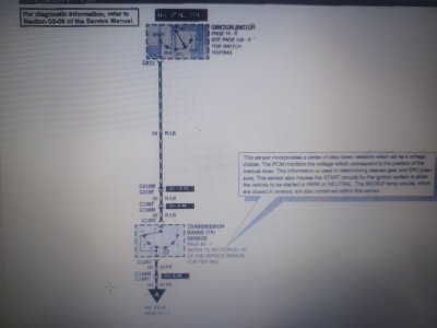

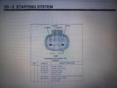

Combining the information from these two sheets (Page from EVTM and install instructions for my new MLPS) , when I start, I should get voltage to the MLPS sensor pin 5 (the EVTM pic) or in pin 1 (install instructions sheet pic).
Current should flow thru MLPS to the pin 8 (or 4), if the MLPS is fine.

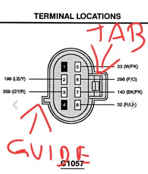

It's pins 5 and 8 per the workshop manual. Pins 1 and 4 are empty pins.
That aftermarket installation sheet, very confusingly, shows the connector pins flipped. You can tell by the pins relativ to the connector tab and guide:
True lol, the whole aftermarket sheet is slightly confusing in nature :D Maybe it tries to depict the cable/harness connector pinout, while the workshop manual depicts the sensor's plug, if that makes any sense? Not sure.
No, because that would just change the order, i.e., 1-2-3-4 would become 4-3-2-1; but it wouldn't flip the pins between guide side and tab side.
That sheet is just wrong in my opinion.

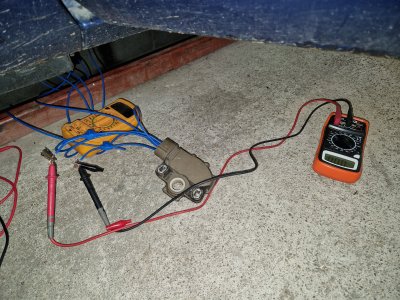

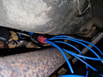

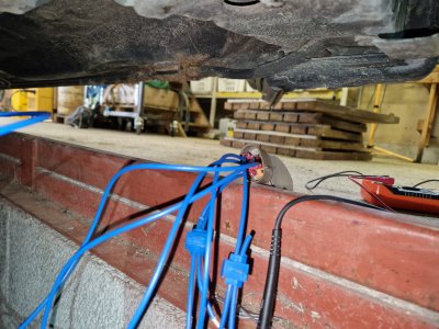

Test setup neat enough to make Mr. Henry Ford proud :D
Some measurements when turning the key to start:
- Battery: 12,4V
- MLPS pins 5 and 8: around 9V
- Starter solenoid/trigger voltage: around 6V
- Starter motor (the one that is hot at all times): Around 12V, same as battery
I'm slightly confused. Something seems to eat the voltage, probably both before and after the MLPS. The workshop that installed the jumper cable claimed that they got no voltage on the starter solenoid, but obviously there's at least some coming through.

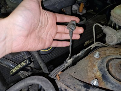

- The cable of the starter solenoid connector is black:1000013852.jpg
According to my copy of EVTM, it should be R/LB = red with light blue stripes. This means that the starter relay cable has been changed, possibly when installing the anti-theft? -> Some parts of the system could be between the MLPS and starter.

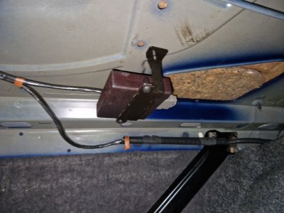

- I have this strange brown box in my trunk, no Ford badges on its sides: 1000013853.jpg
Anyone know if this is i. e. the key remote receiver, or something aftermarket? Looks strange to me.

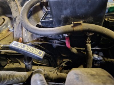

- Some suspicious cables in the engine bay:1000013854.jpg
That's a pair cable coming from somewhere, and their heads taped like this.

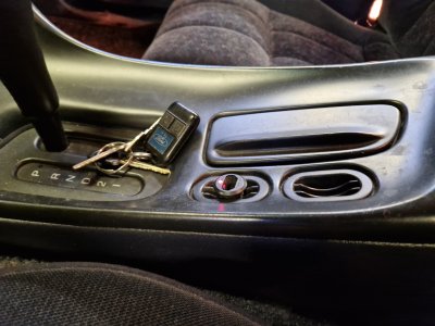

And yes this blinky thing in the "coin holder", in the cabin, this is where I'll be starting the removal job I guess: 1000013857.jpg
