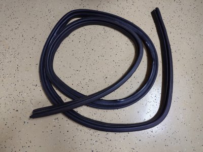

    Sorry, I forgot about this thread until now. I do have an extra one that I don't need. It has minor bacon edging in a handful of spots but they should go away if that portion is laid on top of a straight section of the door frame.

    Sorry, I forgot about this thread until now. I do have an extra one that I don't need. It has minor bacon edging in handful of spots but they should go away if that portion is laid on top of a straight section of the door frame.
    Thanks, but we ended up tapping the flange in just a touch. Seems to sit really nicely now without a slam needed.
