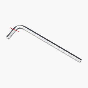

Trying to drain the coolant on my 4.6. Is this the cylinder block plug? (Photo taken while facing forward, driver side, engine oil pan is there on the right) How the hell can I reach that plug? No normal tool would fit.
Anyone who would remember whether this is a 8 mm hex or which size?

I tried to fabricate a special tool from an L-shaped hex key, by cutting it from the red line: 19-2330_xl_1.jpg
But at least on my first attempt it was still too long to get properly seated.
