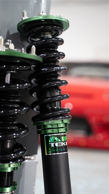

    If you're interested, AirTekk has true coilovers for the Lincoln Mark 8. Require full adjustment and are $1600 though
    Ooooo... dang, I do miss that in my Mark VII. But $1600 is a bit much and I already bought the replacment struts. But dang, nice thought though! Maybe next time when its time to redo the front end and I am still alive.... :P

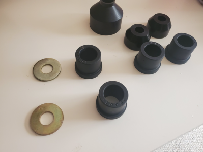

    Found a different shop to complete the Strut Rod Bushings and Sway Bar Bushings. A lot of shops refuse to install supplied parts. Handling is better! Given these are complete, what are these parts left over can anyone determine? The large plastic bit seems like a packaging material
    Given their lack of replacing the SRBs I think you might want to find a better shop.
    Quoted from the other thread. You called it, the guy said "I don't know how they missed it, it was right in front of them"
    I know the big plastic cup at the top is a cover that goes over the UCA ball joint for shipping. Not sure about the other stuff, some of those pieces remind me a little of some of the IRS bushings... 🤔
    I think the 4 matching bushings and two washers might be for the steering rack mounts. The two others look like poly UCA boots
    The two on the top right look like sway bar bushings to me.
