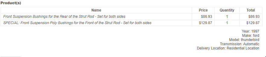

welp ive ordered a set of strut rod bushings from scp, and tire shopping. im gonna sell my cheapo uhp tires, and find something closer to factory height. I was looking at Mastercraft Courser Quest All Season 235/50R17 96V Passenger Tire???
