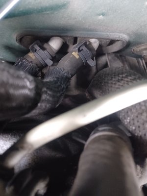

I suppose I should take a good look at the hoses going to the heater core to rule them out. I didn't have a good flashlight handy, it was raining, and I was just over it at that point.

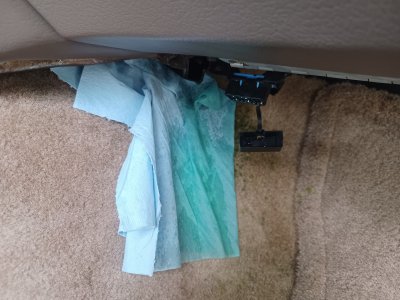

  • Where is all the coolant? The amount of coolant on the carpet just doesn't seem to amount to what was missing from the reservoir. Is it somewhere in the ductwork?

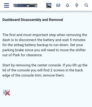

I know there's a tech article entitled "Dash removal and heater core change" by @XR7-4.6 , but I can't see the photos in it:
Could that article be repaired?

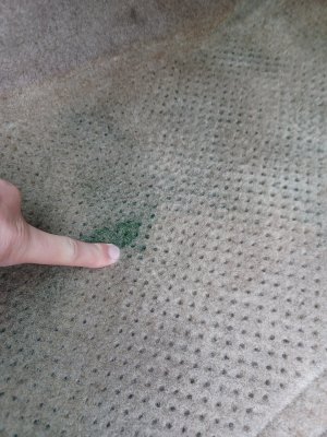

Before asking that question, I should have lifted the floor mat...

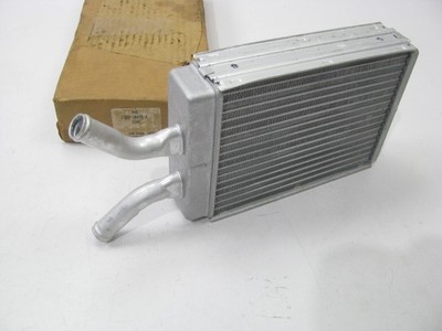

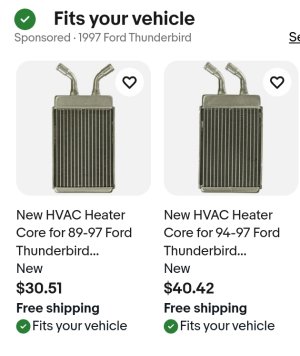

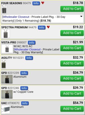

Meanwhile, I'm confused by what I'm seeing on Rockauto. All these heater cores have nozzles pointing into opposite directions; the one on my car has both pointing toward the passenger side.
Any advice on brand or aluminum vs. copper?

I personally prefer the copper, but to each his own. I'm not sure on the heater hose outlet/inlet directions. It has been too long since I've looked at one. This is an OEM Ford part though.
I would go with aluminum. As far as those brands, I have used UAC, Spectra, and Four Seasons before and never had issues with them. UAC and Four Seasons make all kinds of AC stuff and Spectra makes radiators and condensers.
A quick check on Rockauto shows the ones with both hoses angled the same way as being for a 4.6 car. I honestly can’t remember which way they are in my 97 and it is pouring rain right now, but double check which way yours are, and order the one that matches.
Weird. So my car has a V8 core?! I wonder if that's not even original then...
I suspect Rockauto has them listed backwards. I’m not sure, but I seem to remember my 97 4.6 ones pointing opposite directions.
Hahaha! I just came in from outside to check mine for you and yes, they point in the same direction!
Joe, you know what this means? We both actually had V8s all along!
Thank you for checking!
And everybody else. Autozone, Advance,...; they all have them listed the same as Rockauto.
Probably the mix-up originated with Ford, and then everyone copied it.
Yeah, my 91 was originally a 5.0, and I know those point in opposite directions. I’m also 90% sure the 90XR7 also has them pointing opposite directions. My bet would be they had to change it for the 4.6, and then probably decided in 96 to revamp the heater hoses to be able to use the same part for all of them.

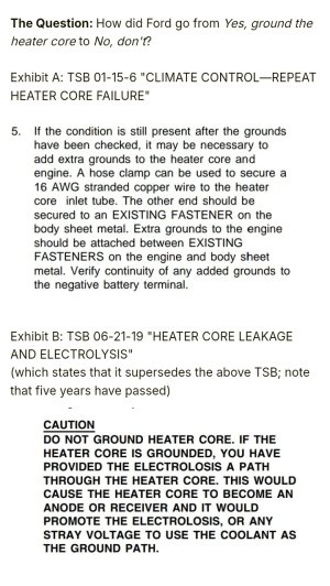

I’m not a fan of those restrictors. First off, the whole cooling system is pressurized, so I can’t imagine it drops the pressure in the heater core significantly. Secondly, every car I have ever been in that had one of those restrictors you could hear the coolant gurgling through the heater core.
Don’t use a restrictor, if you want to do anything preventively for the next one’s longevity hose clamp a wire to one of the outlets tying it to the block to prevent electrolysis.

As for the splayed out heater core outlets vs parallel, 4.6 cars are supposed to be parallel. Either one can be made to work though

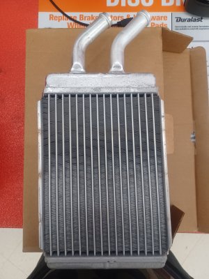

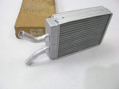

Went to Autozone to look at apparently the only fitting part on a store shelf in all of Virginia, and it was totally crooked, has sort of a left slant:
Seemed fishy to me, so I didn't buy it.

On the subject of grounding, I once started a thread on tstsnbn (screen shot below). Apparently Ford is against grounding.

I would have passed on that one as well. It is definitely supposed to be a rectangle, not a parallelogram.
