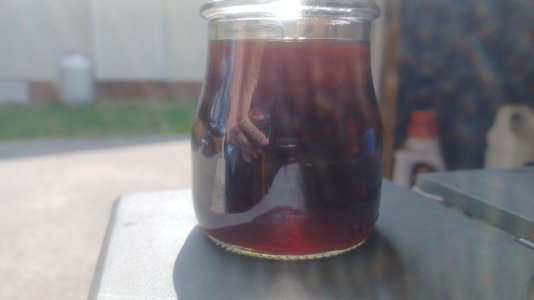

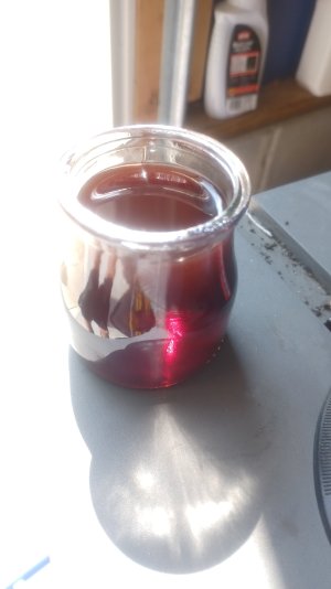

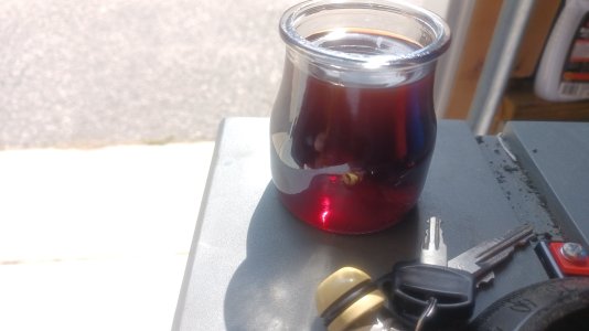

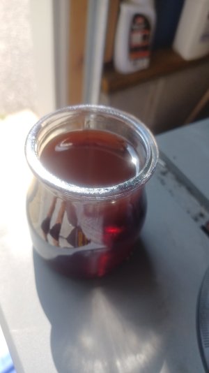

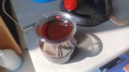

Meanwhile, this conversation inspired me to look at my transmission fluid which is a bit over 21,000 miles old (full drain and refill). I siphoned out half a cup. This is what it looks like: somewhat opaque, but still red, no larger floating matter, and the smell is identical to fresh fluid, though somewhat less smelly.
