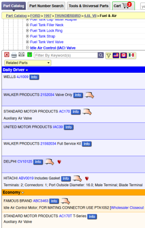

Beautiful, guys: thanks for the quick responses. One question on the IAC: is it a sensor we're talking about, or a separate part, or is the sensor integrated into the part? I see both valve and valve sensor mentioned above.
Also, there's a lot of different brands of IACs still available for the 97. Any one in particular recommended?
It's a V8. Here's what Rockauto shows me (bearing in mind I'm in Canada):
Interesting thing for the V6: Rockauto does not show the Motorcraft one for Thunderbird; however, it does show it for '99 E-150 4.2 V6, which is the exact same IAC, and which is what's on my car. I never looked for the V8 IAC, but I wouldn't be surprised if you found the Motorcraft one elsewhere on Rockauto.
Perhaps, but without some kind of part number or something like your post to confirm for the V8 instead I'd never know for certain. Looks like the original was F6AZ9F715EB, Motorcraft part CX1648. But they're gone.

I'd probably go with the Hitachi or Standard (not T-Series) IAC if you do replace it. I would think he would be able to limp the car along to determine if that were the cause though.
I was told by a RockAuto rep that they only stock what they are told they are getting from the vendor, they do not deduce what it may or may not fit. That is why yuo see various parts that you KNOW do not fit your car, but are listed for it.
