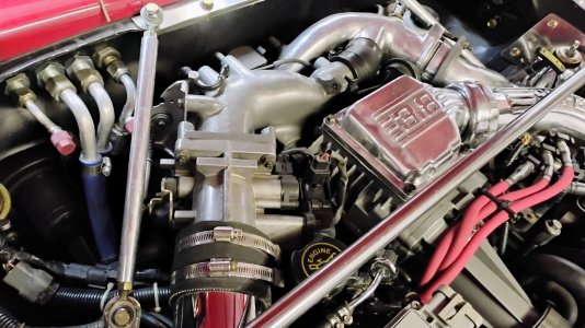

I get gas fumes in the car at different times. Sometimes when it's hot or been run hard.
Everything looks good except there appears to be a little sweating around an injector or 2. This winter I plan to replace all the orings on them.
Is there anyone with knowledge as to best to buy or install tricks?

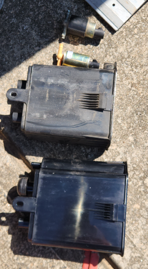

You may want to check your Purge valve solenoid and canister located in the passenger side fender well. Common issue when hot.
*That's if you even have them on that build, just noticed it's custom Comet*

True. Most of the black crap in the injectors comes from the lines, it seems, even though there's not much. E85 car's injectors seem worse. But lots of these cars leak at the injectors and catch on fire Ones 'Ive bought parts from, lol. As long as they don't look wet you're good. Scott is right about the canister being more likely making gas smell. I'd hate not to mention to check, and something tragic happen. The charcoal can isn't supposed to burn or explode. If you trust ford.

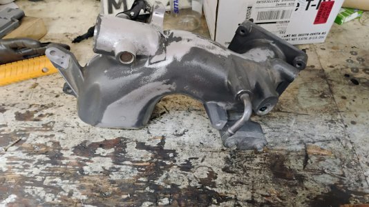

Seeing as the intake system all has to come off I'm going to polish up a piece I missed.IMG_20241009_114539317_HDR_AE.jpgIMG_20241009_114613177_AE.jpg
those vapor lines going to the charcoal canister need to be replaced if not already. the fumes dissolve the rubber lines and they leak vapor. There are a couple sections under Rt side wheel well liner that are not readily noticable. i've always used vaseline or cooking oil on the o-rings for an easy install.
At the moment the tank is vented through a charcoal canister to atmosphere .
