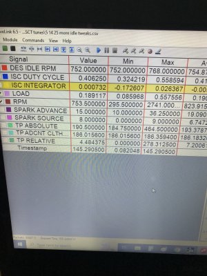

Ok guys I need serious spoon feeding, tuning has never been my strongsuit but I generally learn enough to be dangerous with some direction if it’s explained to me like I’m a toddler. I’ve been datalogging and “tuning”( guessing and checking) to tame this condition but this is the best I got it and it’s still taking manual intervention to keep it from stalling after a very mild rev. It actually idles pretty good once it’s stabilized and in my datalog of this event the ISC duty cycle hovered around .35-.38ish.
This makes me think I should be focusing on Dashpot but I’m having an extremely difficult understanding it even with SCTs help sections and forum input (which has become incredibly limited by SCTs nuking of the Pro racer forum, EECtuning being down and Decipha’s site/forum speaking a completely different language from SCT).
Anyway, you tell me, in this vid I saved it from stalling every time it dipped to near 500rpm and at some point you can see how it stabilizes to the commanded 750 rpm. Even just a hint on what to log and what to mess with and what not to mess with in PRP would be helpful. Right now I’m in over my head
Log ISC_Integrator. It will tell you how much to add/remove from your idle airflow table to help dial in the idle from the IAC perspective.

Yep I missed that one! What's your thoughts on the Duty cycle though? I had been reading to shoot for like .15-.25 where mine at idle is pretty consistently at .38ish.
I honestly hadn't read much about it. You could open up the throttle blades a tad if you want to lower it, but I'd probably leave it alone unless there are other symptoms after dialing in the idle airflow.
The rationale as I understand it in lowering the duty cycle is the ISC is less likely to surge down to the point it stalls as seen after I rev it up and let the rpm’s fall, and this should be done beforehand. I did a quick log a few hours ago and while the integrator is definitely not on target it’s not quite as off, but the absolute lowest the duty cycle went was .37 with a high of .59(which was probably when it was warming up commanding a higher idle).
I’m supposed to apply the data from the integrator to the ISC neutral/drive idle air sections in PRP, correct?

Yeah, add or subtract the ISC integrator value from the airflow #/min in the corresponding cell of the idle air table.
I don't know if drive idle air means anything with a manual, I'd probably just modify both to be safe all the same.
