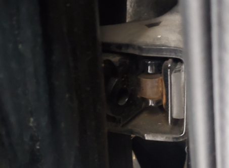

    No play on the open side of the door. There's some rust color dust in the driver side hinge, but I don't sense any issues with movement. The passenger side does not have the rust powder

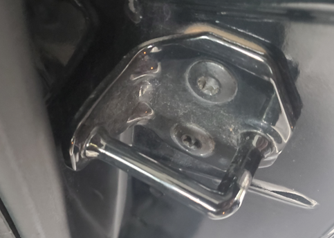

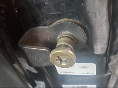

    Bushings.. Now I picture that to be the intermediate material between metal on metal right? Are we talking between the striker plate and frame, or between the door contacts?
    Bird: Looks worn but functions well
    LSC: The lighting is weird, this is visually black except worn where its contacting. Looks similar on the passenger side, but less worn (go figure)
