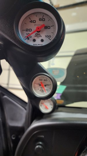

So I installed a mechanical oil pressure gauge years ago in my A-pillar gauge pod. It appears that some of the pictures have been lost over the years, so I took some new ones while I was fixing my odometer last weekend.

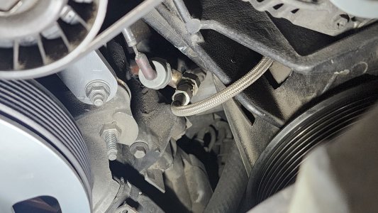

I installed an 1/8" brass street tee (one end has male pipe threads, the other two openings are female threads) and an 1/8" brass street 90º into the factory sender location near the waterpump on my SC.

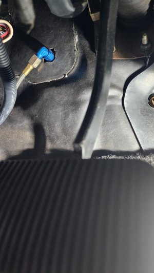

I installed a -4AN bulkhead fitting in the firewall. I drilled through one of the clutch pedal dimples in the firewall for the location. Then added a -4AN street 90º

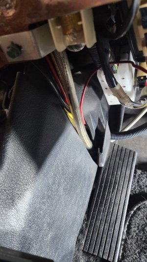

I installed vinyl tubing over the braided stainless so the stainless steel wouldn't rub through any of the other wiring in my gauge pod.
