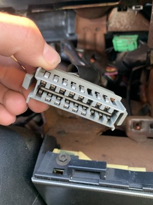

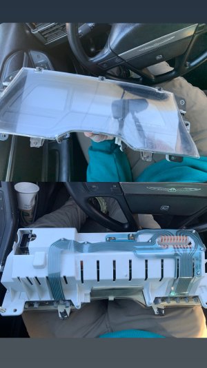

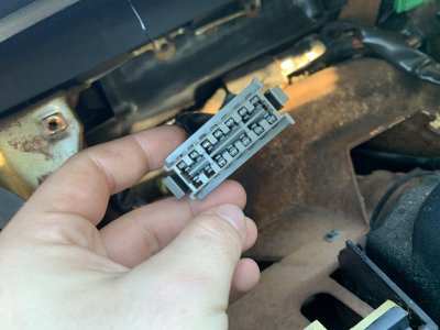

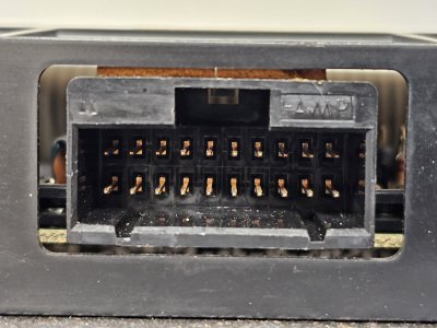

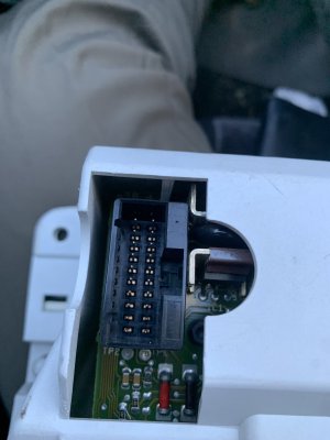

Trying to swap these 2 displays, what would be required for this? Is there an adapter or will I need to rewire. Also what the connectors called. Any info would be appreciated, using repair manuals only is a pain.29889EE3-5B07-442B-A95D-B4065E0FCACF.jpeg0809C3BC-1F46-4C14-AEE1-07290D047D23.jpegIMG_1404.jpegIMG_1401.jpegIMG_1409.jpeg
What you want isn’t a repair manual, buy a Ford EVTM(Electrical Vacuum Troubleshooting Manual) for your year and it will have the diagrams and exact connector pinouts you’d need for this conversion. I’d give you specifics to the point you wouldn’t need one if I had done it but I haven’t. Either way when it comes to any kind of electrical an EVTM is a must have.
The biggest task with that cluster will be getting the various fuel metrics to readout, which involves running a wire from the DOL(data output link) pin on the EEC connector to the cluster. That will give you the MPG, distance to empty etc data for the display.
Also you’ll need to change oil pressure senders to the analog type(not literally analog) the base cluster your car came with uses a normally closed switch(no oil pressure=light on) Analog clusters and the digital cluster use normally open switches(no oil pressure no needle movement or in the digital case no bars).

Do you have the harness pigtail for that black connector on the digital cluster?
I will be home later this week and can get you the diagrams for the clusters. What years are they from/going into?
It’s a 1990 thunderbird and the part was claimed to also be from a 1990 thunderbird. I believe it’s actually from a cougar. I don’t have a harness pigtail for it, i’ll find one.

That black connector that you are missing is the same connector used at the VMM. I searched my whole shop to find the broken one I had thinking I had the pigtail with it. Unfortunately I do not, but I can confirm it is the same connector. Maybe that will be fairly easy to get.
Hopefully will be an easy find. Thanks for your help.
