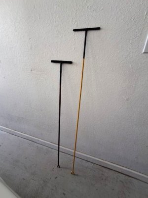

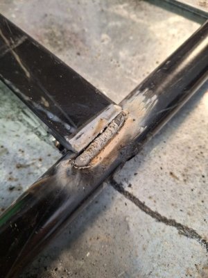

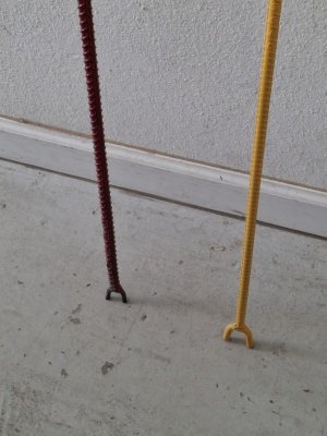

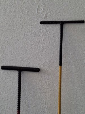

    I was making a new valve wrench for my water shut off valve. Using 3ft long rebar, I flux welded the T for a handle and cut a piece of 5/16" thick chain link in half to use as the end of the wrench. Turns out it was a bit small and did not fit over the valve. I have an oxy / propane torch set (inherited), but need the gasses and was thinking of heating the 5/16" chain piece and bending it open some.
    I even thought of using the torch to weld some items when the flux welder won't do the job. I read some articles about the oxy / prop torch and it seems to have mixed reviews as to what it can do.

    So, DA me realized I could take a large, thick pry bar and pound the u shape open more. That worked great!

    As for the T handle; my employer has several "home made" varieties in different lengths and sizes, but its basically what you made except with a section of square tube steel welded on the end.
