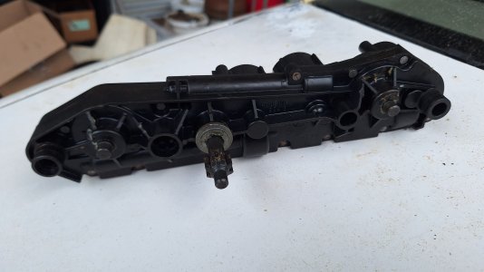

Regarding slow, weak motors...I've heard stories of dried, caked-on white grease inside the gearbox making it difficult to turn. I have one motor that sounds weak when just free-wheeling. Am I correct in assuming that the gearbox pictured in the attachment, with the rivets all around the edge, is what people speak if when they say the grease must be removed, the unit cleaned, and grease replaced?

I've never taken one of those gear boxes apart to be honest. When we had those tracks on durability it was usually the motors that failed, but that was in a controlled test lab environment and in a compressed time frame. I believe those motors had thermal protection devices that would shut them down if they got too hot. Once they cooled down they would work again, but they were never as strong after that. We used to blow air over the motors to cool them down a bit, but that was with the tracks constantly running for weeks on end.
I'd kind of be surprised if the grease in there is slowing it down, but whatever is in there is 30 years old so it can't hurt to take it apart and clean and regrease. It looks like 10-11 rivets that would need to be drilled out. I believe the motors for the vertical actuators are the same as the horizontal actuator so you could also try swapping motors around. The verticals don't get used nearly as much as the horizontals.

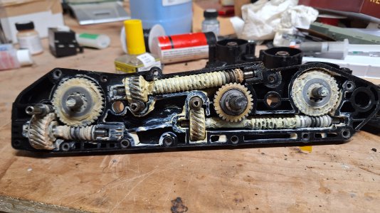

You will find this! All the drive chains are worm gear driven. The long worms have tiny metal disks at the end of the shafts. Keep track of them! The grease was in good shape but I cleaned it out anyway.
The rivets spin when you drill them. They get hot and melt the plastic and push out. I wouldn't recommend anybody take one apart for that reason.
