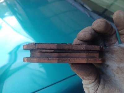

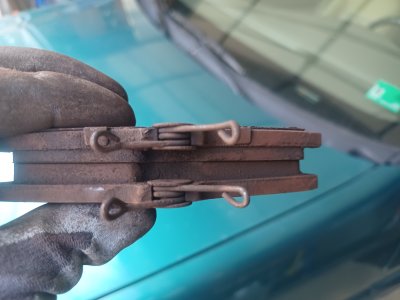

Once removed, my previous observation was confirmed. The inside pad is more worn, though at an apparent angle:

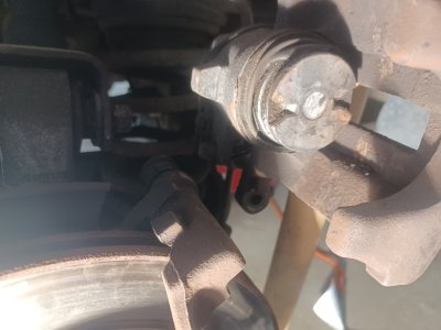

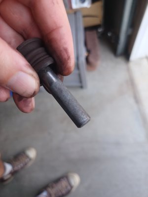

Slide Pins
My first course of action was checking the pins. They seemed to slide just fine though. I did clean them and apply new grease, but it didn't seem necessary.
Note how part of the pin is shiny; the majority of it is dull. Is that corrosion?

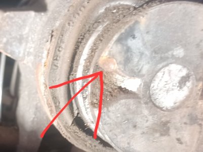

I found that the piston indentation was not aligned with the nib on the inner brake pad:
As you see, the nib on the pad has actually worn a dent into the piston. That I think explains why the inner pad is more worn towards the upper end.
I was able to rotate the piston a few degrees before reassembly, but I realize that's just a stopgap, and new pads are needed.

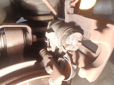

Piston Boot (or whatever it's called?)
Upon initial disassembly, I was greeted with this:
The rubber boot, or parts thereof, was just hanging there. I cut off the loose part. There was no leak of any sort. Can I just replace the boot, or does this require a new caliper?

Was so tedious! The springs on the pads keep pushing the caliper out. Am I missing something? Or is this normal? I feel you need to apply an odd amount of force to align the caliper with the pins to fasten the pin bolts.
Those bolts, according to the Ford workshop manual, are supposed to be replaced with new ones (?). I'm guessing nobody does that? The manual also calls for a specific torque value, but my torque wrench doesn't fit in there. I went by feeling, which is scary because I have no frame of reference. They're tight.

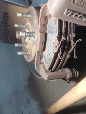

I also found it odd that the pads sit right on the bracket. The corrosion could affect proper pad movement (?).
Recently I assisted my roommate in doing the brakes on his Cadillac ATS, and those pads sit on small metal holders which come with the new pads.

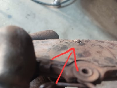

Is it normal that the metal brake line makes contact with the knuckle here? Seems oddly tight...but who am I to judge.

The boot can be sourced in a rebuild kit but you have to remove the piston to replace the boot and it is not fun on those calipers!!! Better off just replacing the caliper… or just ignore it, the boot doesn’t effect its operation
The pin being misaligned with the piston will indeed cause that wear made the same mistake the first time I ever changed pads.
Don’t worry about the pad/bracket corrosion, they can corrode but under operation they won’t, just like the bare rotors

The line might be slightly bent, no harm really, you can unbend it away from the knuckle if it bothers you
It can wait until I replace the pads, but yes, it kind of bothers me. The whole point of the slide pins is that the caliper has lateral movement; but the line making contact there effectively restricts lateral movement.
Yes but the caliper and by effect that portion of line moves towards the hub when the brakes are applied as well as through miles as the pads gradually wear, giving more clearance with the spindle. With fresh pads you simply took up that clearance but as long as it wasn’t actively interfering with the spindle(which would have made reassembly difficult) there’s really no harm in it just touching in the static position.
Believe me - with the braking forces the caliper exerts when you apply the brakes, that flimsy brake line touching the spindle isn't going to keep it from bending out of the way to let the caliper center itself if necessary. When you grab it to bend it out of the way, you'll see what I mean. :)
