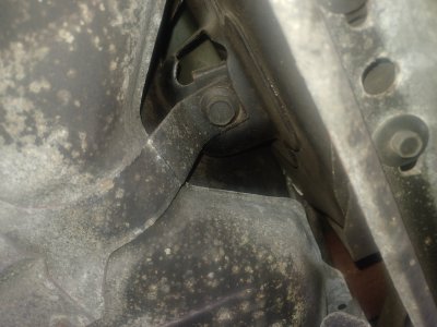

Moving on to whatever this thing is called, it looks fine. Not sure what it does; I'm guessing it restricts movement of the subframe (?).
Moving further back, is it normal that this hanger doesn't have rubber all around but instead has that empty hole at the bottom?

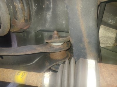

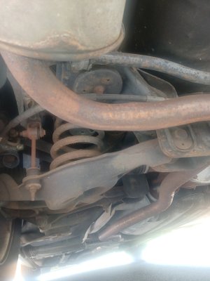

These control arms seem to sit differently. See how one sits further forward than the other?

The rear differential mount is normal. If you've had a 4-wheel alignment done, ask them for the printout of the spec of the rears (most shops don't know the rear has adjustment points).... but unless you've changed out control arms or bushings, it's probably the factory alignment. Gas tank has two straps - 4 attach points.
There is a slight difference side-to-side in the rear uca's, the body attach points are different to match. You have marginally more rust than Lazarus; If it bugs you, drop the irs, scotchbrite the parts and paint them.New bushings are available from RA.
Body to IRS bushings are only available in delrin, from bill.
