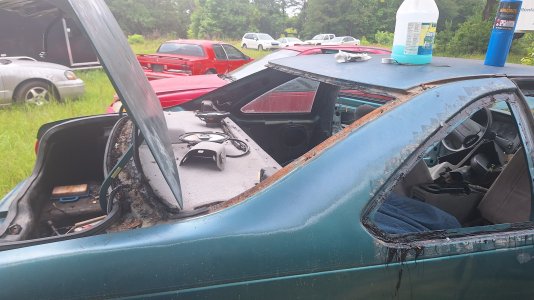

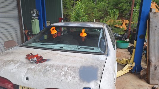

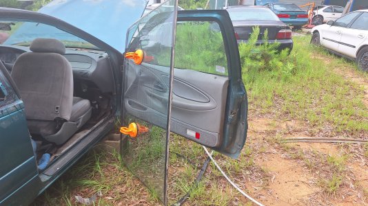

I think I'll be able to get it out intact but it won't be easy and it will wear me out physically. Thanks for your opinion. I'll post a picture either way.
Which car is it for? I just stepped through Safelite's web page and they quoted me $788 for a new rear glass installed in my '95 LX. I think you are right to not spend a lot of money on cosmetics until you are ready to put it on the road.
Safelight wouldn't even quote it for me.
For the naysayers in the group...never say never!

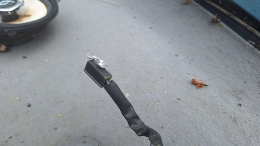

The glass isn't yet installed in the white 95, it's just sitting there. There was a casualty though. When disconnecting the defroster wire on the driver's side, it just snapped away from the glass. I'm hoping to find a way to fix it. I live in the south and we rarely have snow or ice but it is really convenient to have a defogger if needed.

IIRC you can get kits to repair the defroster terminal on the glass. It's a conductive glue that you put them back on with.
Thanks man. I'll do some searches. As far as the difficulty of the job, it wasn't too bad but it was miserable. If anybody wants to know how I did it, I'll make a post describing it. No special tools required, just a propane torch...
