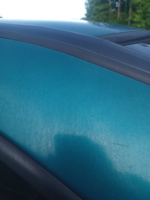

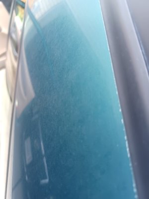

I haven't done anything other than washes. I just wasn't confident, fearing I'd do more damage than good. I think the previous owner polished it as there was some white residue along the edges.
If you look at my initial photo closely, you see those weird vertical streaks. Not even sure what that is.
Looks like it might be some water marks, though its hard to tell as its not like a clearly defined water spot or anything. I know fords have soft paint but judging how yours doesn't seem to have any clearcoat failure I say that you would be fine to try a fine cut polish and just be gentle and see where that takes you.

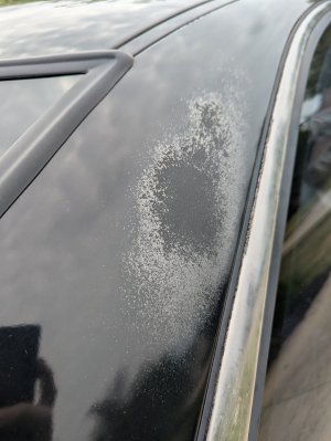

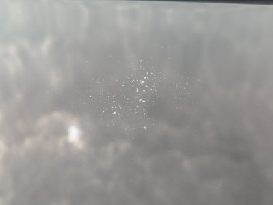

Yeah, clear coat failure manifests as an ugly oxidization/peeling on these cars that starts off with white spots/pitting in the clear, that slowly grows with an obvious lack of sheen/gloss over the areas where it has baked off completely.

Tried a clay bar. Surface is smooth, but absolutely zero effect on those dull streaks.
Then move to a cleaner wax. It's possible that Terminator was correct, and the clear is starting to oxidize. Even if so you should be able to make it last longer with the steps I have above. If you rub a small area really hard with the cleaner wax and it doesn't get better, you know it's permanent fading. I'd tell you to we sand it, but knowing Ford clear coat of the era, there may not be much good clear left.
Hard to tell, but I think you're safe to move forward. I think you'll see some improvement.
If you hate yourself do this under a florescent light. The best paint looks like shit under good lighting. You can, however, get the best results under florescence
I am the absolute last person you should consult with for washing/waxing/detailing, but that looks more like hard water stains than failing clearcoat. Then again it is always hard to really represent finish sheen in pictures (at least for me). I would try with a cleaner wax and see how it comes out.
