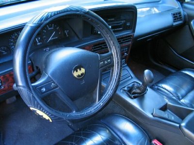

You can have the donor flywheel machined to the proper imbalance. I did this to my 5.0 M5R2 swap many years ago.
