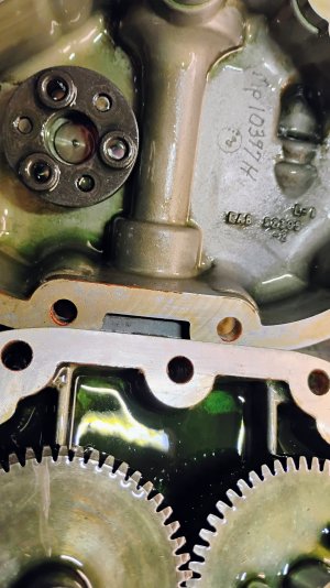

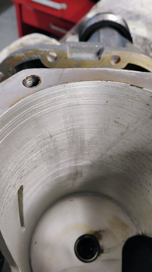

Here are the bearings you need.
You also need the anaerobic sealer, and while you have it all apart, I would at the very least replace the coupler with a solid one as well.
Or you could rebuild the snout completely while it is apart with a kit like this.
Replacing them is pretty straightforward. Remove all the bolts around the snout, take the snout off, then separate the rotor pack from the case and remove the rotor pack, then just knock out the bearings and press in new ones.
