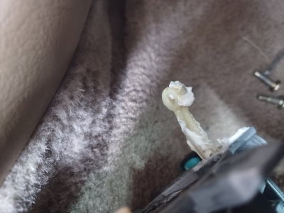

In this episode of owning a daily driver from the last century, I get into my car in the supermarket parking lot, turn the key, the starter briefly kicks in, then snap!, then silence.
The ignition is ON, but the key turns loosely in the key hole.
I immediately figure it must be those two off-white plastic pieces in the column. I remove the lower trim, the ignition switch, and start the car "by hand". The steering column lock and shift lock are both unlocked, so I'm able to drive home. Where I arrived a minute ago.

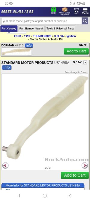

  • Are there OEM parts? If not, any particular aftermarket brand preferable?

I can only find one of the pieces on RA, but I know there are two. And I can't verify tonight which one is broken. I assumed they were a set.

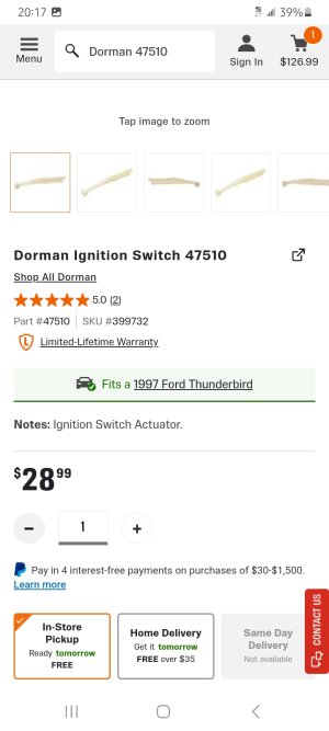

At $7, or even $29, it isn’t worth pulling apart a column in the junkyard, other than for practice on your own car. But I would just replace it and not worry about it. The ignition switches on the 89-93 columns fail all the time, but it is a rare occurrence on the 94-97 ones.
That’s wild I’ve never actually heard of an IRL instance of that piece breaking
I’ve seen it twice, however both of those cars were high mileage neglected beaters, one of which had deployed airbags. This is the first time seeing it failed on a nice low mileage car like Martin’s.

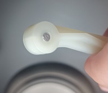

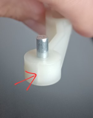

My roommate took me to the only late opening Autozone around, which had one Dorman unit in stock, I bought it, and now looking at it closely, it seems the plastic is already splitting. Or is this normal?
View attachment 11971View attachment 11972View attachment 11973
Not seeing any splitting, but my eyes are crap anymore.... Maybe that is why it was the last one. I took a chance at getting one from RockAuto that was the last one.... I missed a bullet on that one.

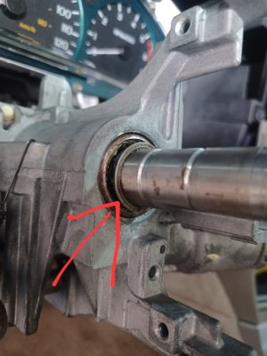

Do I have to remove this ring?
I'm kind of stuck right now. The two bolts holding the upper tier column are out, yet it doesn't budge. The tilt spring is out. I think the two little tilt arms at the bottom are the issue (?).

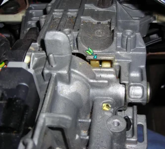

It’s not in the steering linkage. You’re looking in the wrong place. The issue is in the ignition linkage.

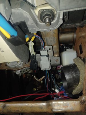

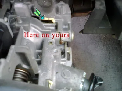

With the column tilted down and the key in and turned back one notch you can see the linkage that I'm talking about where the column pivots and the pin that connects them should be.
You can see the pin in mine in the picture below. Make sure that your pin is in place and the linkage moves forward and back as you turn your key. This is where mine seperated and I had the same "car won't shut off" problem that you described. My guess is that your pin has fallen out too. I marked the location on your car in the second photo below.
I fashioned a coat hanger and hooked the lower linkage in the eyelet where the pin was missing and pulled it back to turn the car off. This is a good temporary solution until you can get it fixed.
You'll need to remove the two screws that hold the steering column in place to replace that pin. Be careful of that big spring that pushes the column up when you release the tilt steering lever.

I actually found the pin. It was in the compartment that the steering shaft goes through.
It just apparently fell out, but the plastic piece doesn't even look broken at all.
Yeah, I know, enough grease.
The pin goes back into the hole firmly, too.
Now reinstalling it is the next mess...

This line here.

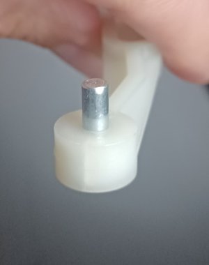

Did you mention in your other thread that you had an extra one? (Maybe I misread?)
If you have one, could you check if it has this same line there?
I saw that and thought it was part of the metal post, a portion pinched out so it won't turn in the plastic. But you know best, if you say its a crack, well then, by God, it's a crack. Are you going to return it? Or get another one?

For the removal to make sense, i.e., to get free access to the lower actuator, you must also remove the steering shaft from the column, which I'm sure involves more disassembly (?).
With the shaft inside the column, the lower actuator is limited in upward movement by the wheel lock. That's why inserting the upper actuator requires some sanding.
