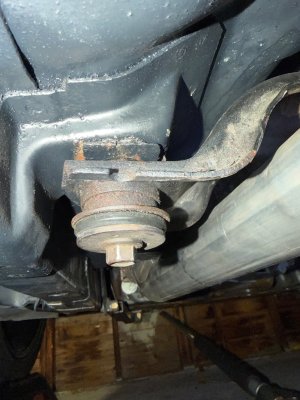

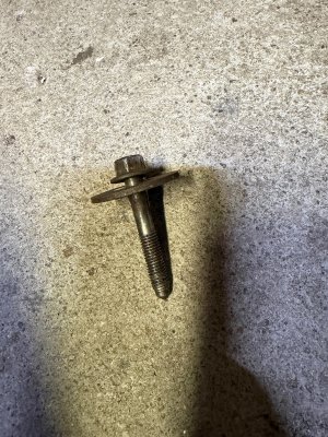

Ericv8thunderbird Veteran Poster Joined Sep 23, 2023 Messages 822 Location Massachusetts Vehicle Details 1994 Thunderbird LX Jan 17, 2026 #1 Hey guys, I’m looking for 1 transmission cross member bolt and speed clip, this is all I need to get everything buttoned up underneath. Attachments IMG_4722.jpeg 3 MB · Views: 5 IMG_4723.jpeg 4.2 MB · Views: 5
Zep5.0 1991 Cougar LS, 347ci, AOD Birdcats Supporter Joined Sep 22, 2023 Messages 1,778 Location Waterloo, Iowa Cars in Garage 1 Vehicle Details 1991 Mercury Cougar LS 5.0 Jan 17, 2026 #2 Ericv8thunderbird said: Hey guys, I’m looking for 1 transmission cross member bolt and speed clip, this is all I need to get everything buttoned up underneath. Click to expand... There is enough space to get a fender washer and nut in there. That's what I did. The window in the cross member allows for a box end to go in there and hold the nut. Just use a collared nut so that the box end can hold it down
XR7-4.6 Administrator Staff member Joined Sep 12, 2023 Messages 6,251 Location Roselle, IL Cars in Garage 1 Vehicle Details 1994 Cougar XR7 DOHC TR3650 Jan 17, 2026 #3 I did that with my friends SC, there wasn’t enough room to get the wrench off the nut and afaik his box end wrench is still stuck underneath the car
Ericv8thunderbird Veteran Poster Thread starter Joined Sep 23, 2023 Messages 822 Location Massachusetts Vehicle Details 1994 Thunderbird LX Jan 17, 2026 #4 Yep, I almost let that happen. I got it figured out though!
