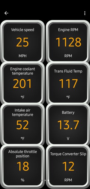

Inspired by @theterminator93 's response to @GRWeldon 's thread, I went ahead and added the Ford TC slip PID to my dashboard in OBD Fusion.
The Good
At steady cruising in 3rd or 4th over 40 mph, slip reads anywhere between 0 and 4 RPM, with rare spikes to 6 or 7 RPM. That sounds just about right.
At anything other than steady cruising, such as acceleration or driving in lower gears, slip fluctuates a lot, too much so to make exact sense of it, though it appears within an expected range (couple hundred RPM).

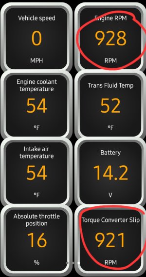

Where the data falls apart is at a standstill. Logically, at 0 MPH, I would assume that TC slip should be = engine RPM. Wouldn't that make sense? Or am I missing something here?
Instead, the app shows TC slip at more than twice the engine RPM. Can anyone explain this? Or is it likely a programming mistake in the app?

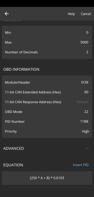

My guess is there's some generic formula in the app that applies to the raw data from the bus which works for "most" applications but with our early OBD-II designs isn't quite the same. It might also be calculating the data using different data sources than the LiveLink PIDs which produces a different result, especially if one of the data sources used in the calculation is extrapolated data from other sources due to said data source not existing on our PCMs.
Without the duty cycle PID I agree that the most important takeaway is nominal levels of slip during cruise. The slip during acceleration seems high at first glance but may be commanded (again, no way to know without the duty cycle PID).
Sorry, I do not. I just use the built-in PIDs in LiveLink that the software detects are compatible with the strategy of the PCM it's connected to.

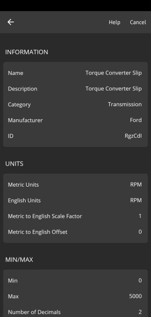

Right, but even for built-in PIDs, in my app I can go into properties, and it displays a formula plus various other things. Example below for torque converter slip:

Up to now, when locked, data made sense (close to zero); but at idle at a standstill, data made no sense (should be equal to engine rpm, but was way higher).

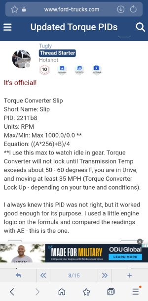

I came across this truck site today:
After updating my formula accordingly, my readout at standstill does indeed (approximately) match engine rpm. Whatever small variance exists, I attribute to the values refreshing at different intervals.

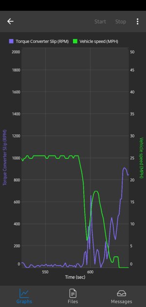

In 4th at highway speeds, lockup is essentially permanent. What I find more interesting is the behavior of "controlled slip" which is mostly prevalent in 3rd.
The screenshot below shows me driving through my neighborhood in 3rd; the screenshot below that shows the same drive followed by my final turn into my street, and then pulling into my driveway.
The behavior here at 25 mph, purple graph, shows slip fluctuating between zero and 40 rpm or so.
I have no reason to believe that this wasn't normal! Everything is smooth, and the behavior makes perfect sense for optimum fuel efficiency. I just don't particularly like it.
In these neighborhood street, I'd prefer if the torque converter simply remained unlocked. Incidentally, that would not increase slip by much, because throttle input and load are minimal; but it would eliminate the low-rpm lugging sensation when going uphill. Hence my question yesterday in the Unofficial Stupid...thread about a potential TCC disable.

Adding this little tidbit. I remembered the app also logs. This is the same drive segment as shown in the graphs above, up until the initial speed drop to turn into my street. First column time in seconds, second column speed, third column torque converter slip. Note that the time stamps don't match the graphs above because the log is for the entire drive; the graphs were started mid-drive.
Interesting to see what that controlled slip actually means in RPMs.This is a flat-ish part of the neighborhood with constant very mild ups and down; think continues, very mild right-foot adjustments.
