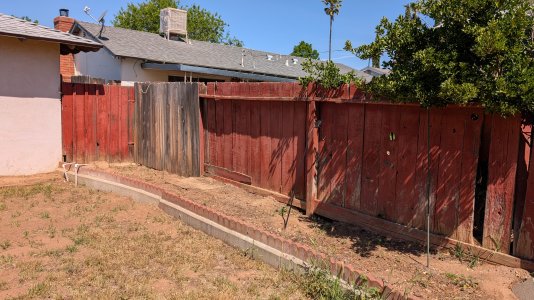

I'm debating with my wife on redoing my fence with my neighbor as a DIY project or paying someone to do it for me.
Or maybe have it be a halfway DIY project. The hardest part for me would be to ensure that the posts are all lined up properly. The "halfway" part would be to hire someone to do the posts and get everything lined up for me and then I just go and finish up the paneling myself.
What I really want is for a cinder block pony wall topped by vinyl fencing.
Put a post at each end get contractor string stretched tight and use a level on the post so it touches the string and is vertical, plump.
Have you thought about the lawn? :unsure:
Are there Lowes or home depot stores there?
Like Fred said, contractor's string, a plumb bob, and something that will dig post holes. Concrete, posts, and prefab fence sections. If they allow irrigation systems, I'd consider it. The last fence we put around the pool is plastic, rated for 25 years.
The original wood fencelasted about that, but required painting every few years.
You could just replace the bad boards, and paint it.

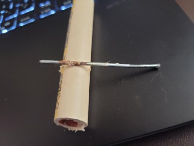

Since you were talking about pipes you all might find this interesting. A few years ago I was replacing my laundry room sink. I had to pull the baseboard trim to finish it properly. Everything was going great..... until I removed the last nail from the trim. After pulling it out water started spraying out of the wall. :2eek:
Apparently when the house was built, and the trim was being installed, a worker shot a nail right into the CPVC water pipe.
Somehow it never leaked, until I pulled it out. You can even see the mineral buildup on the nail where it went through the pipe.
I guess the nail was hot and going fast enough to form a seal.
