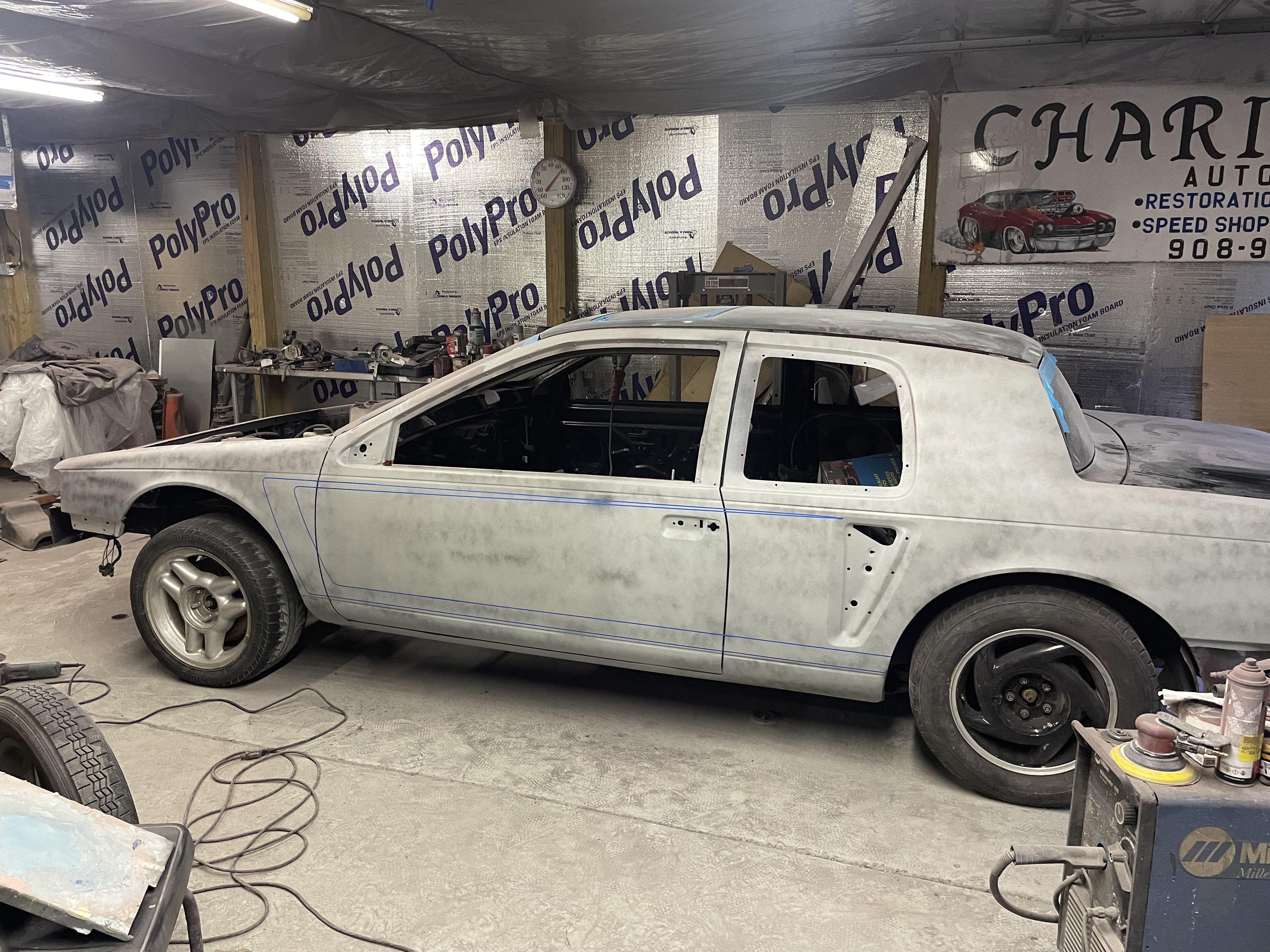

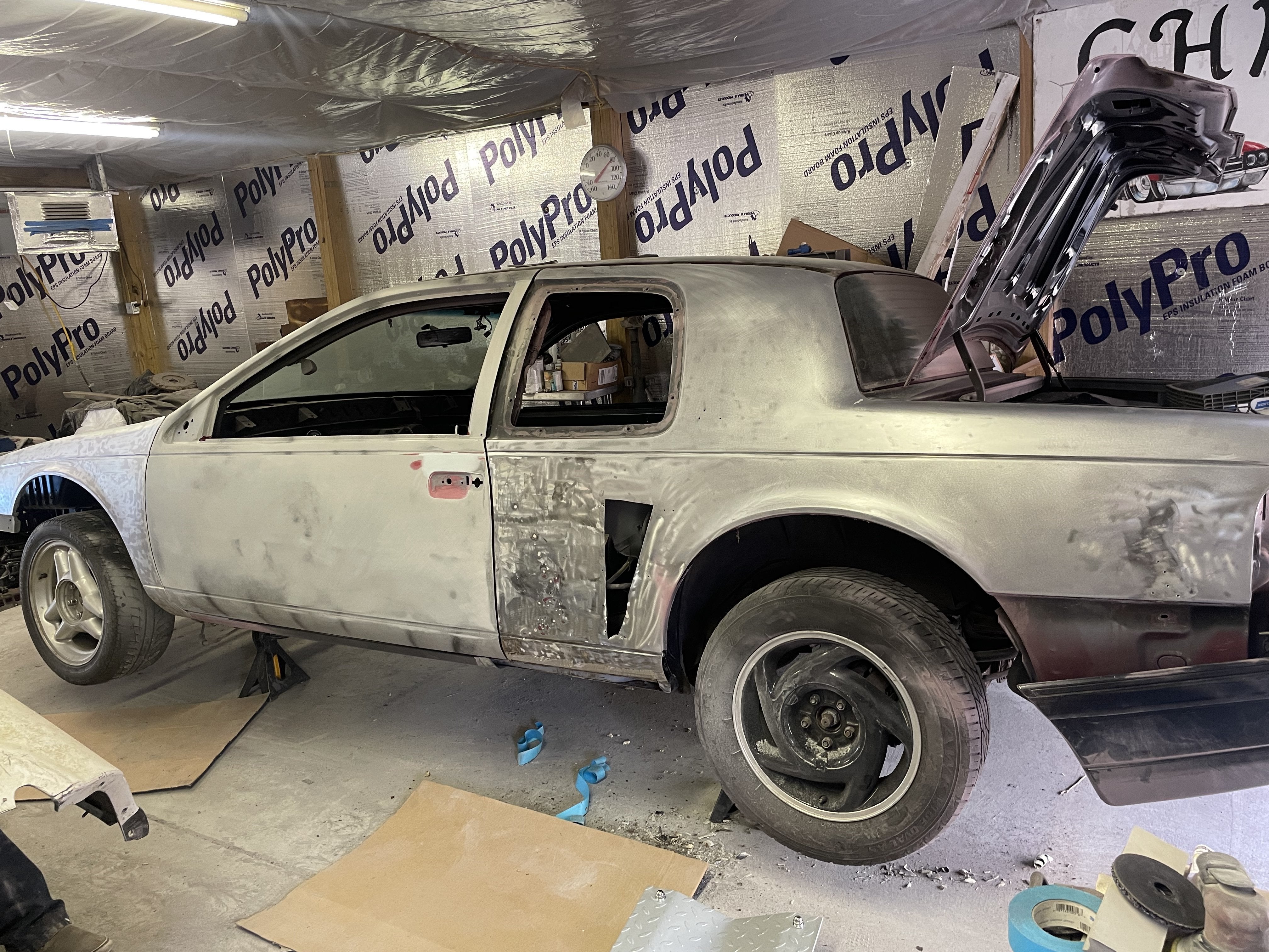

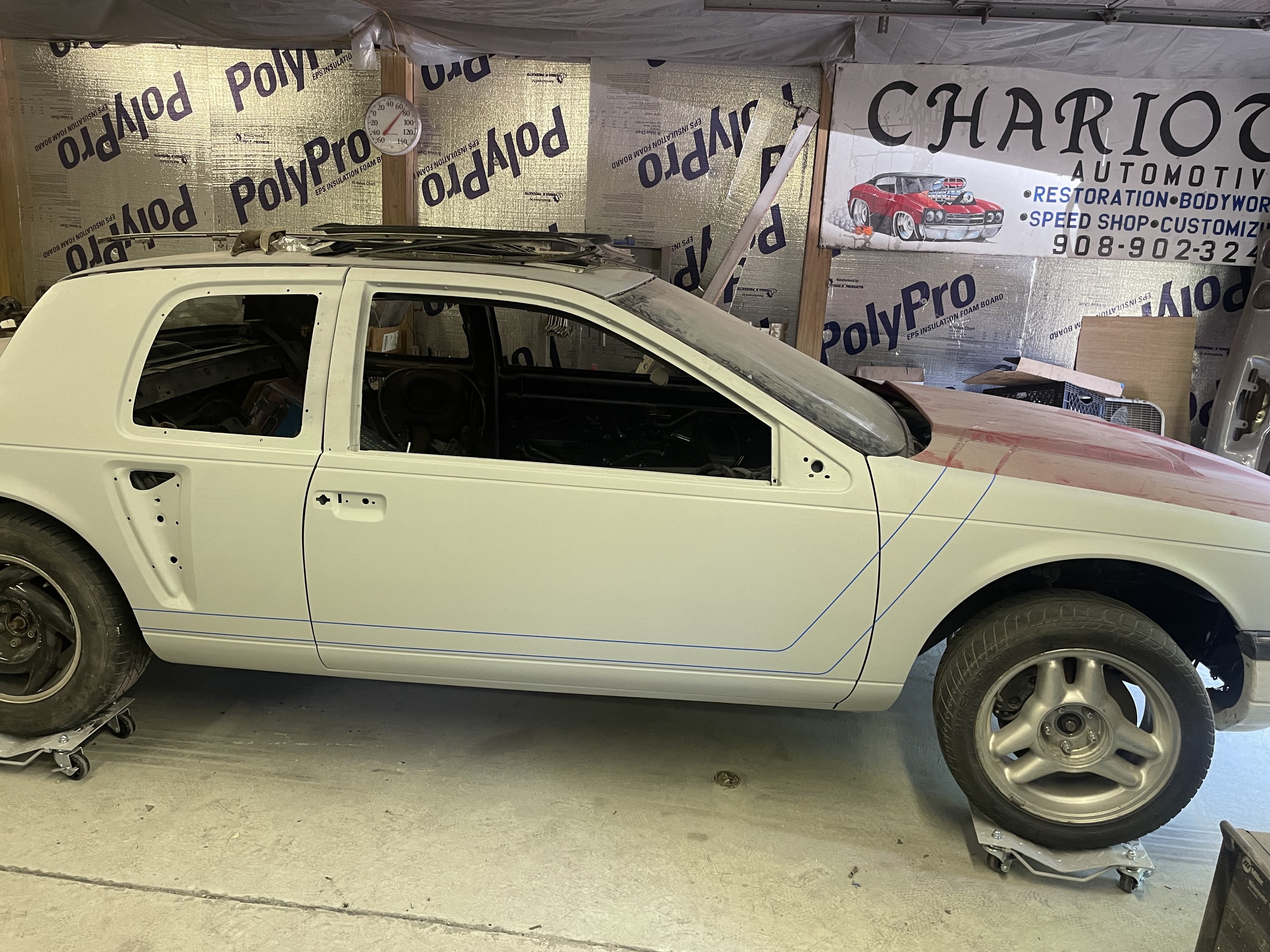

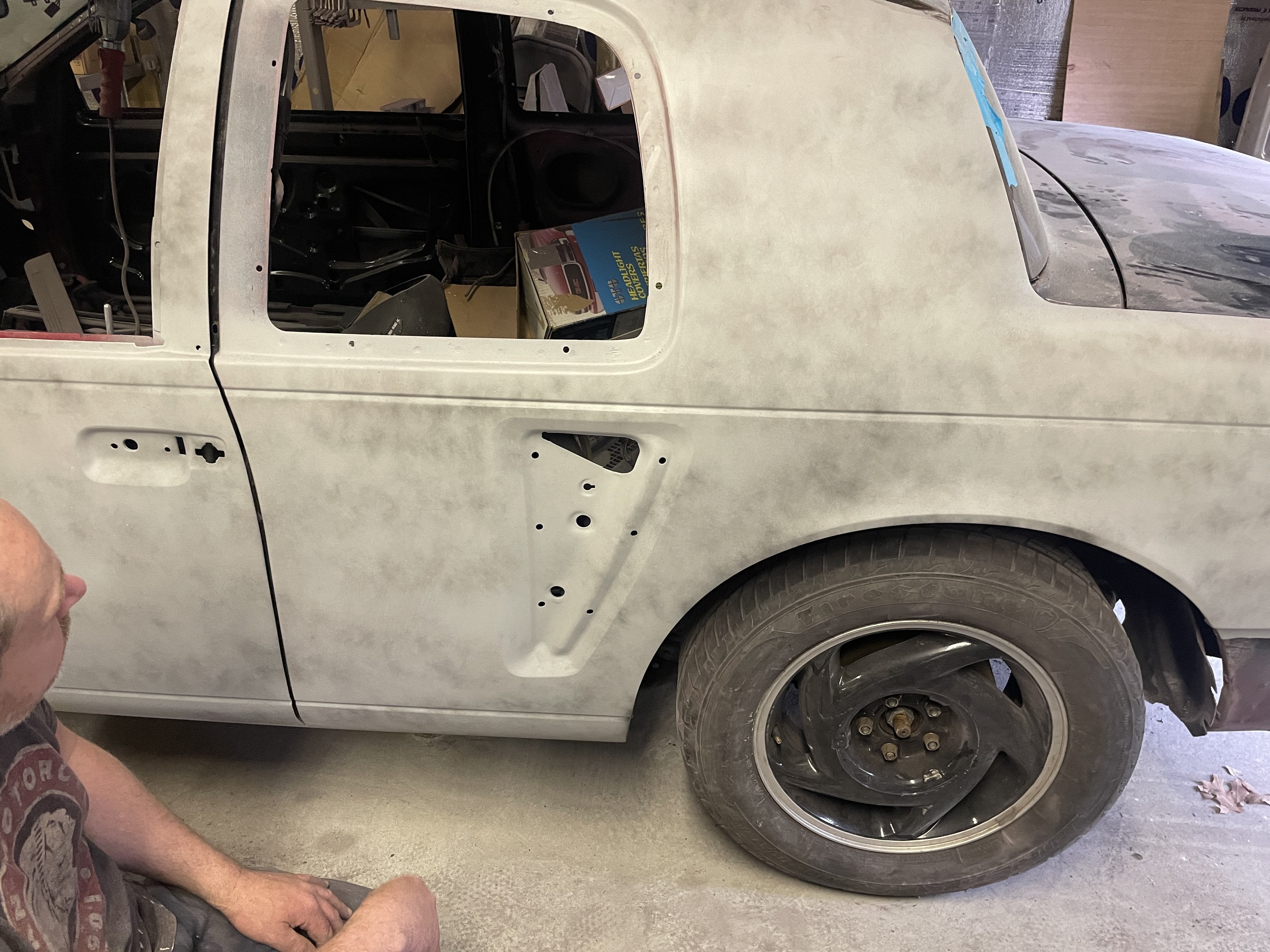

A couple months ago, the guy who did the body work way back when called me up. He had gotten too busy with work to continue at the time, and he just assumed I got someone else to finish it up, so he never followed up. Now he has quit his job and built a shop behind his house to do custom body work, and he does one car at a time, and asked if I wanted him to finish it up He came to my house to re-assess the condition of the car, and about 3 weeks ago, we towed it down to his house. What he has done so far since it has been there;
-Repair last remaining minor rust at back of both rocker panels
-Hung and aligned the doors and fenders
-Minor body work needed on one door and one fender. Both doors were already in primer and the fenders he stripped to bare metal, repaired some minor damage to one, and then shaved the antenna hole on the other

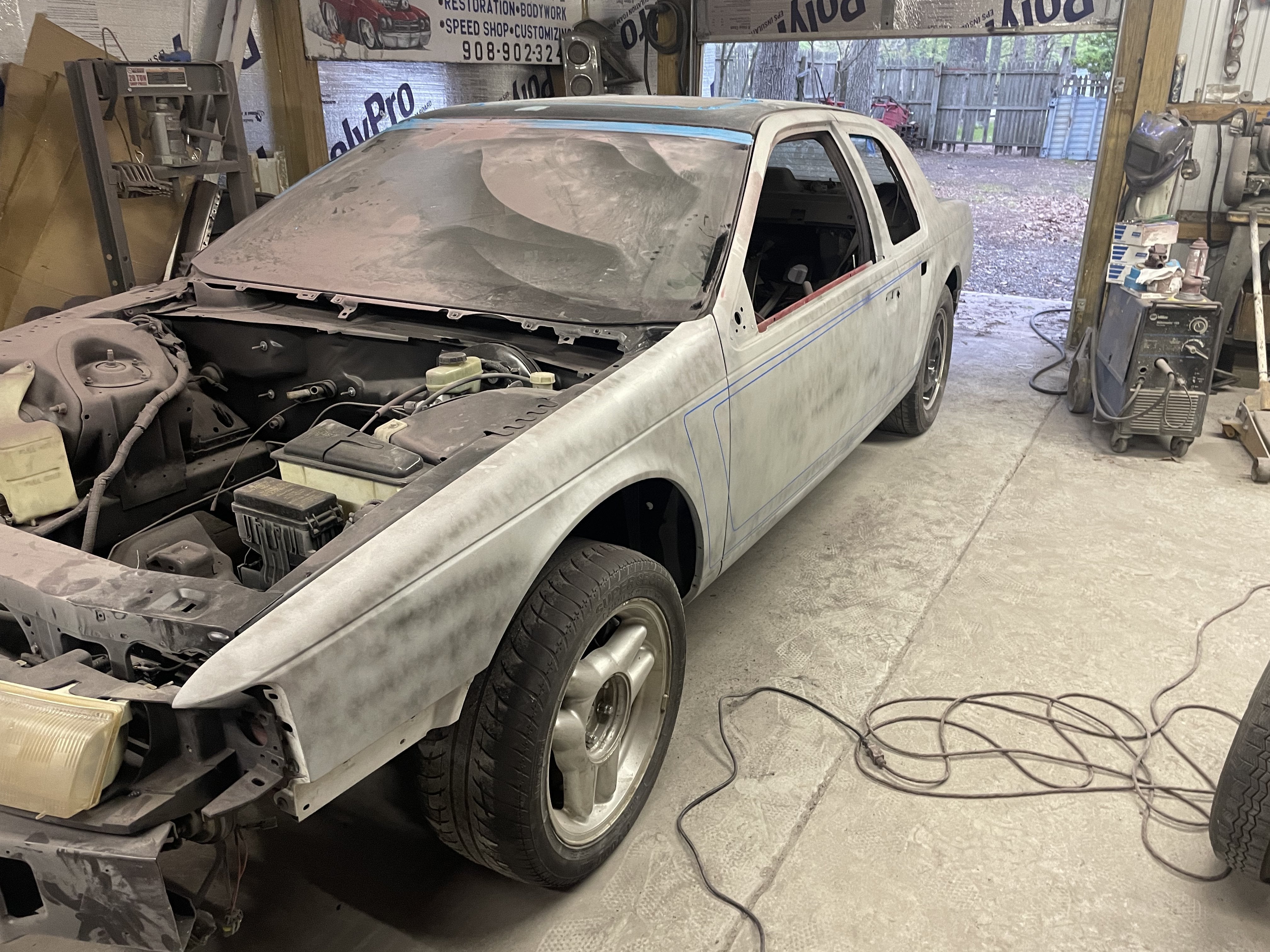

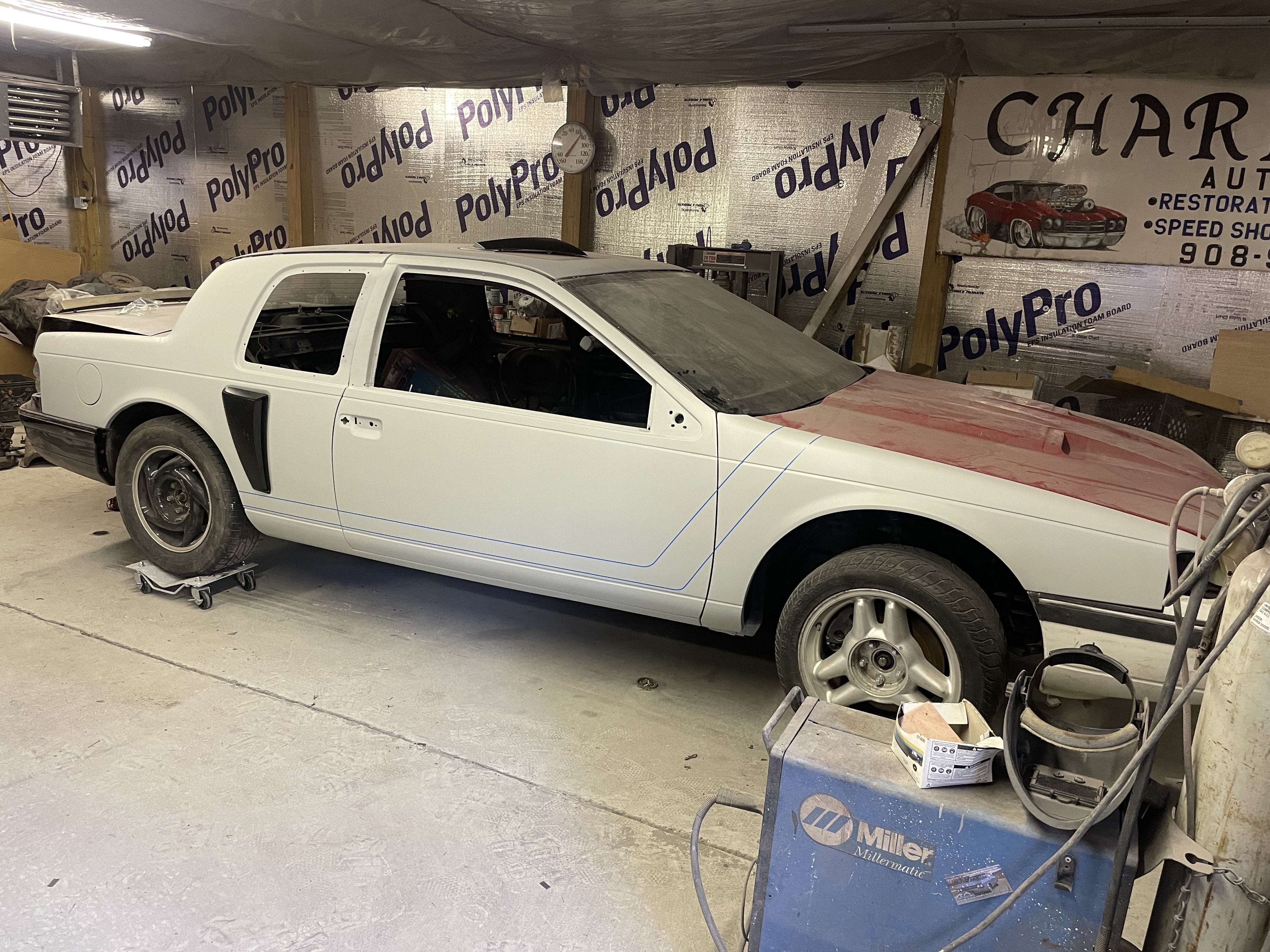

-Entire car stripped to bare metal, all dings and dents fixed

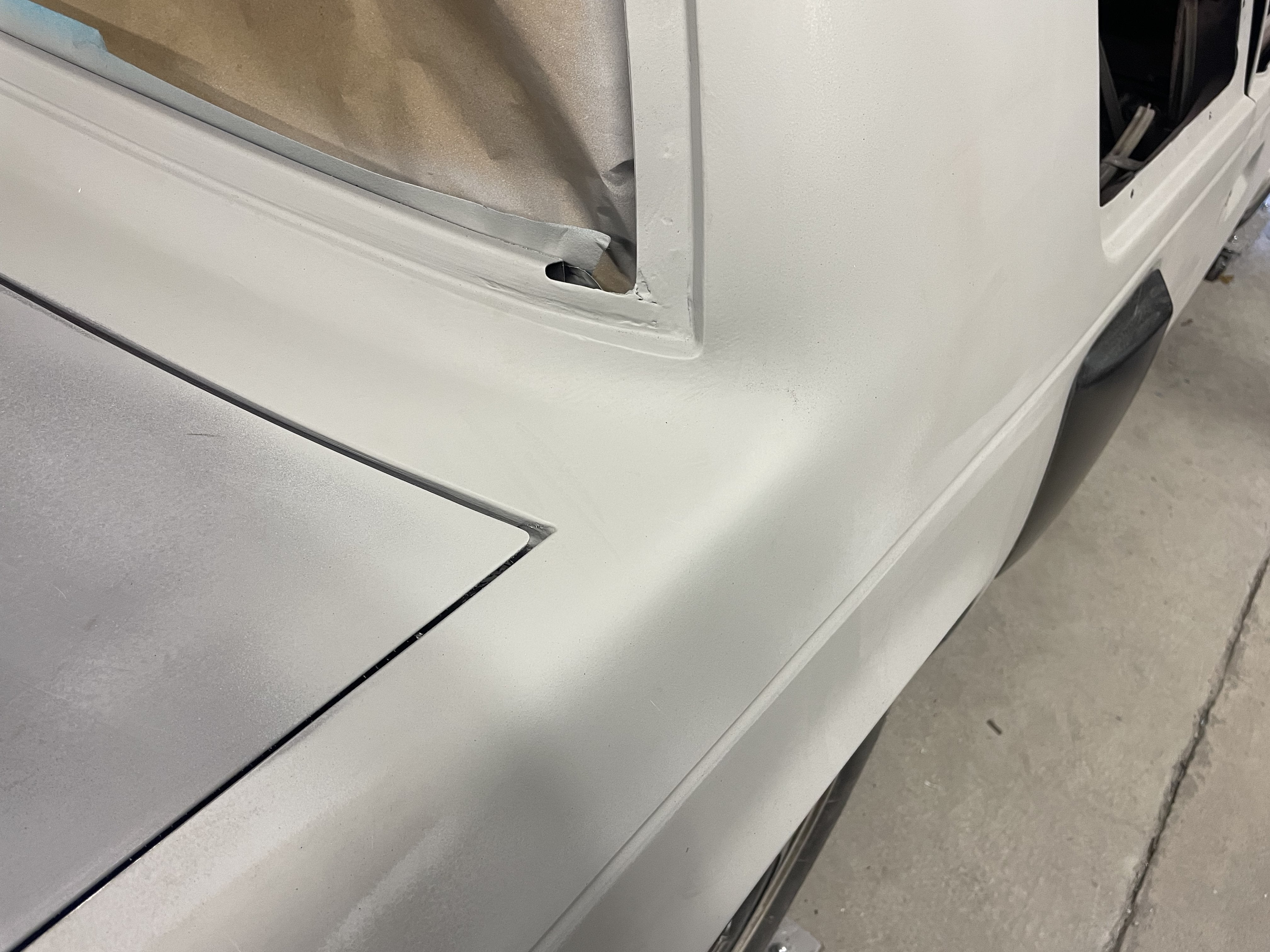

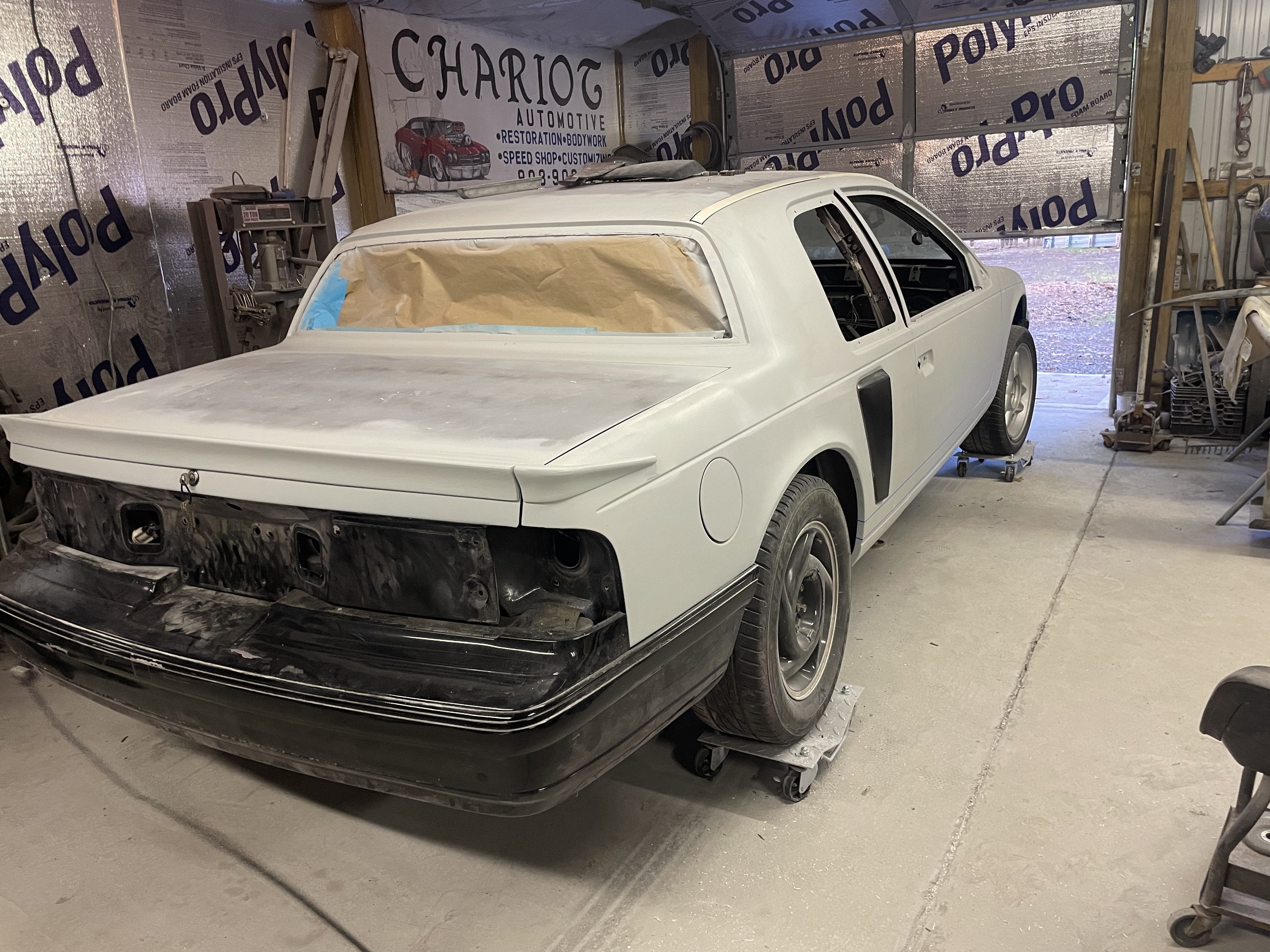

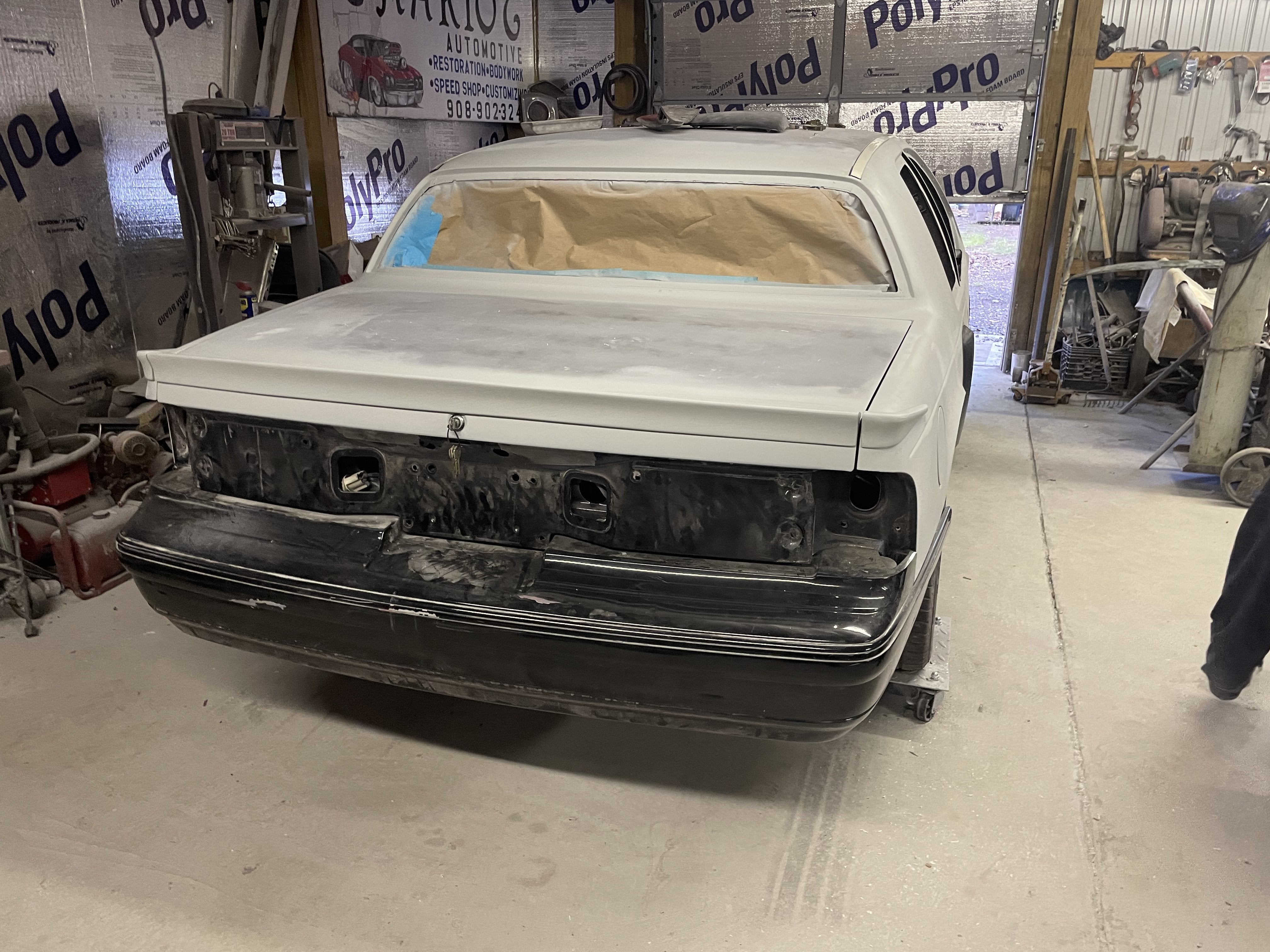

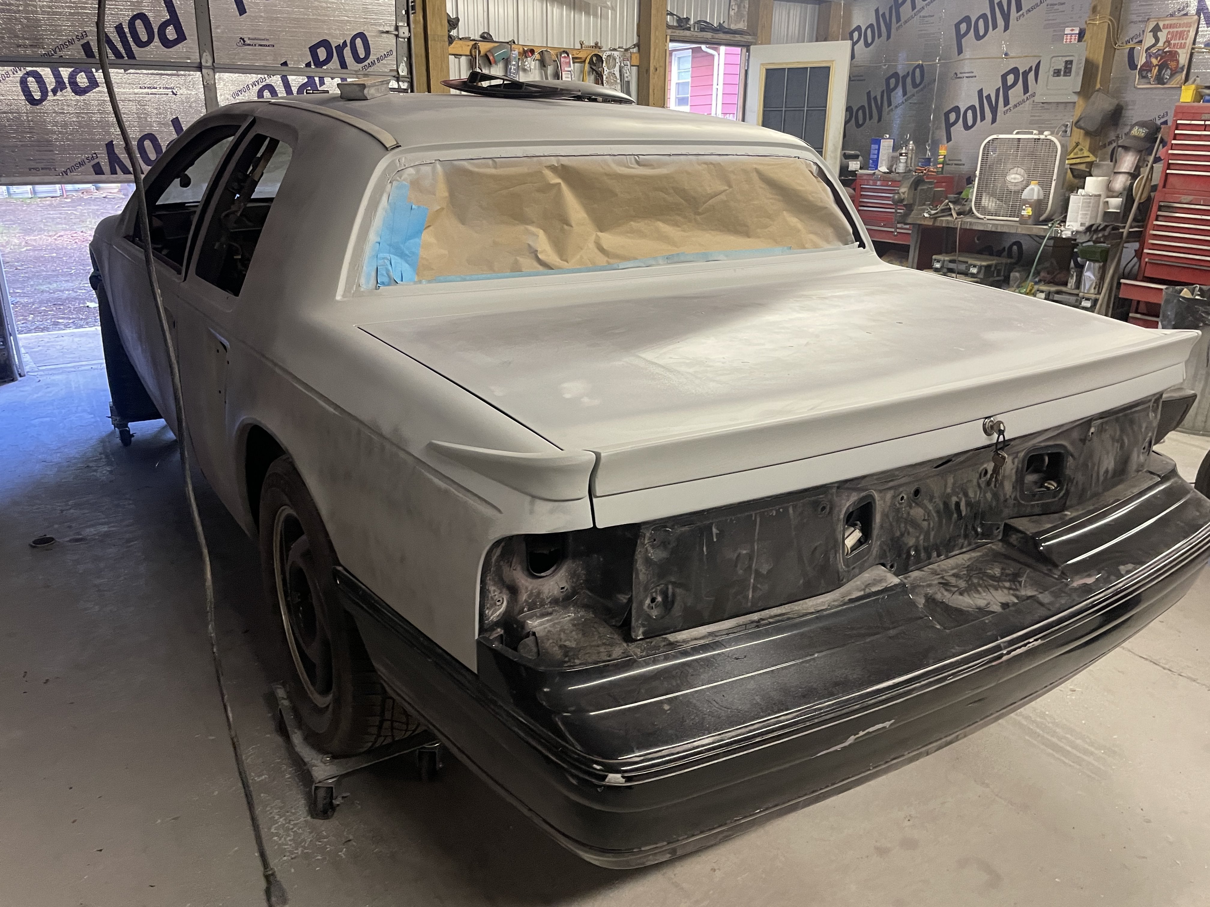

-For the Mustang quarter scoops, I wanted to keep them, but also upgrade from the V6 style to the 01-04 V8 style, and do a better job of it. He went to the junkyard and cut out the sections of the Mustang quarter panels where the scoop attaches, and grafted those in, so now the scoops attach and can be removed like factory.

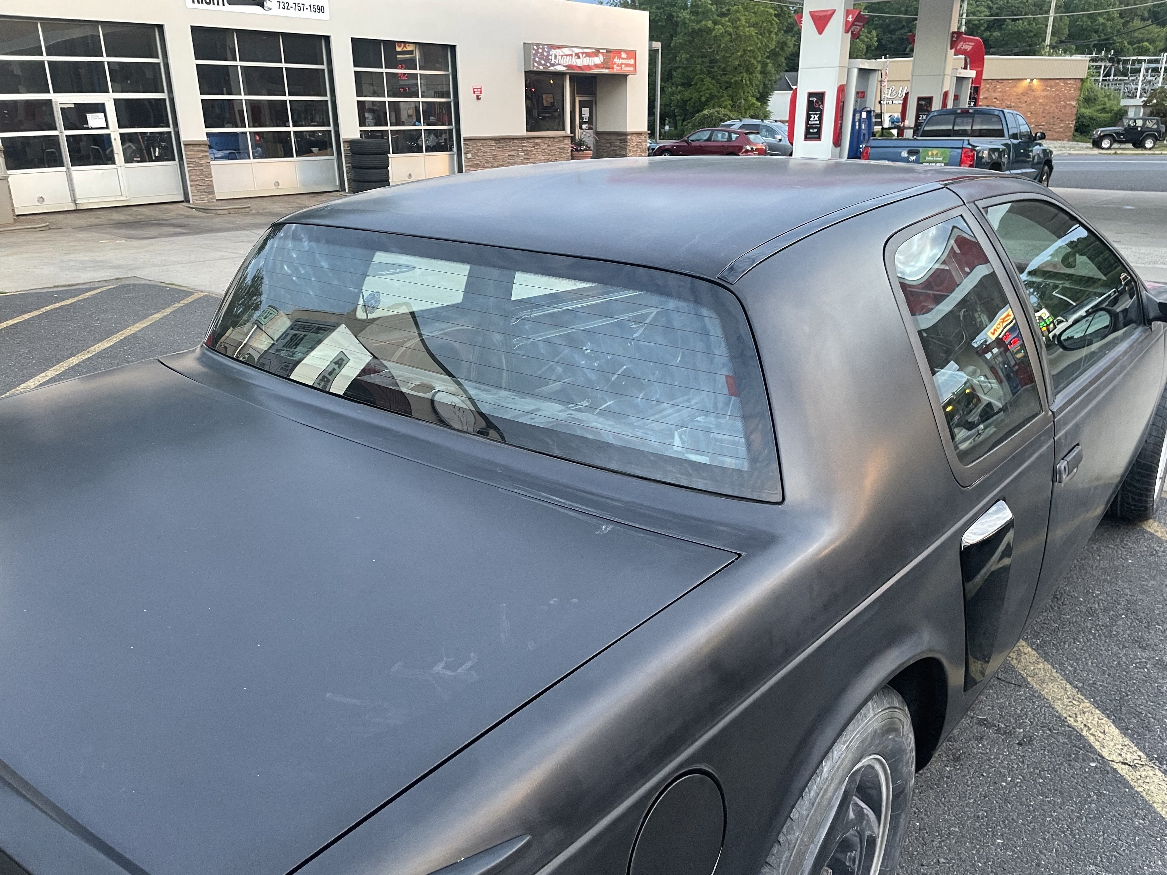

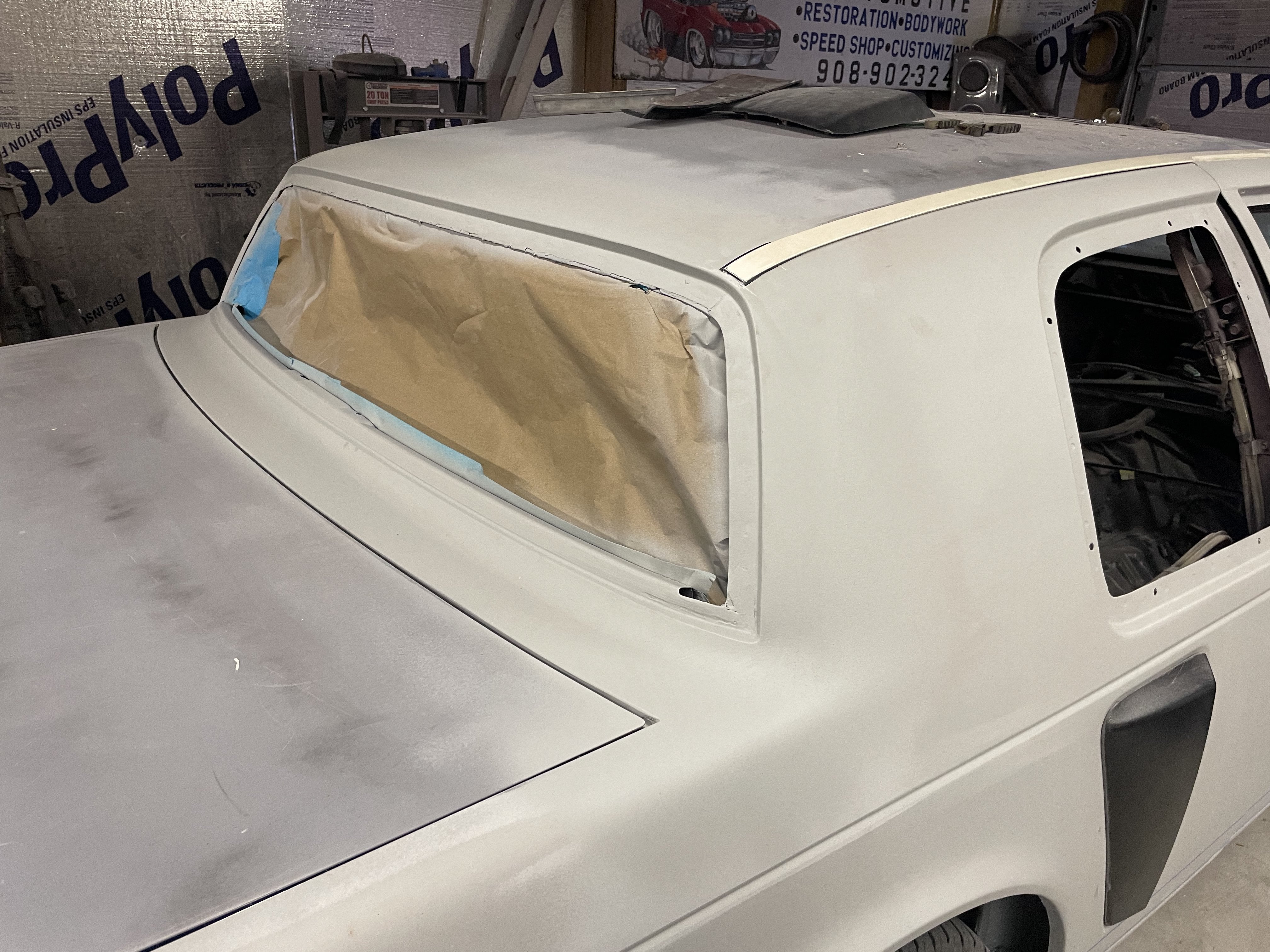

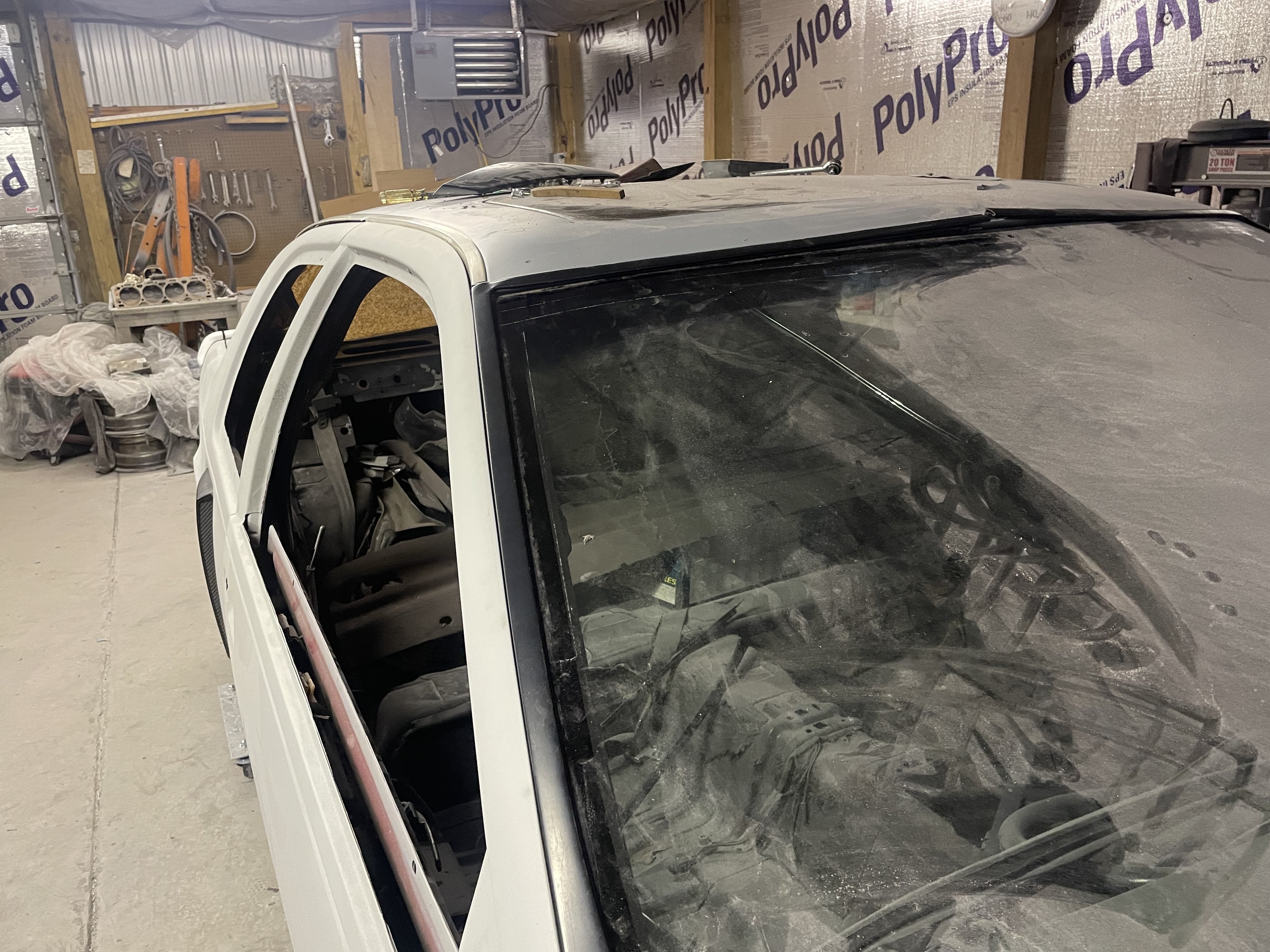

-The rear glass has been removed, thankfully in one piece. The seams between the quarter panels and the cross piece under the rear window were welded and shaved, and the bottom of the window opening was filled in by about 3/8”. This makes the window sit perfectly in the opening with no rubber molding, so the rear glass will be flush mounted with about a 3/16” gap all the way around.

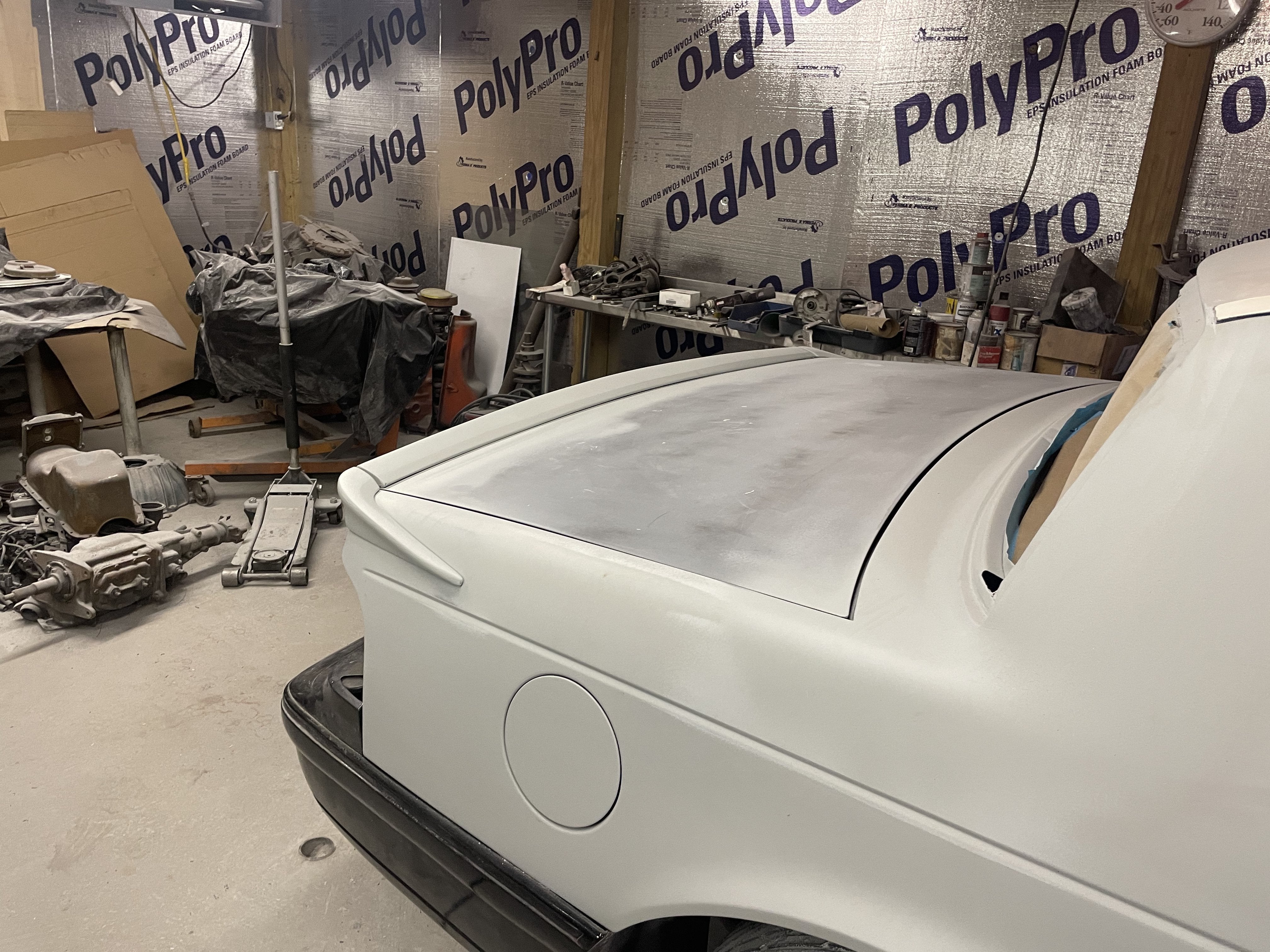

-Last but not least was a custom spoiler. The side pieces are off another car, but had to be significantly modified, and then the center section is completely fabricated, and all pieces are still removable.

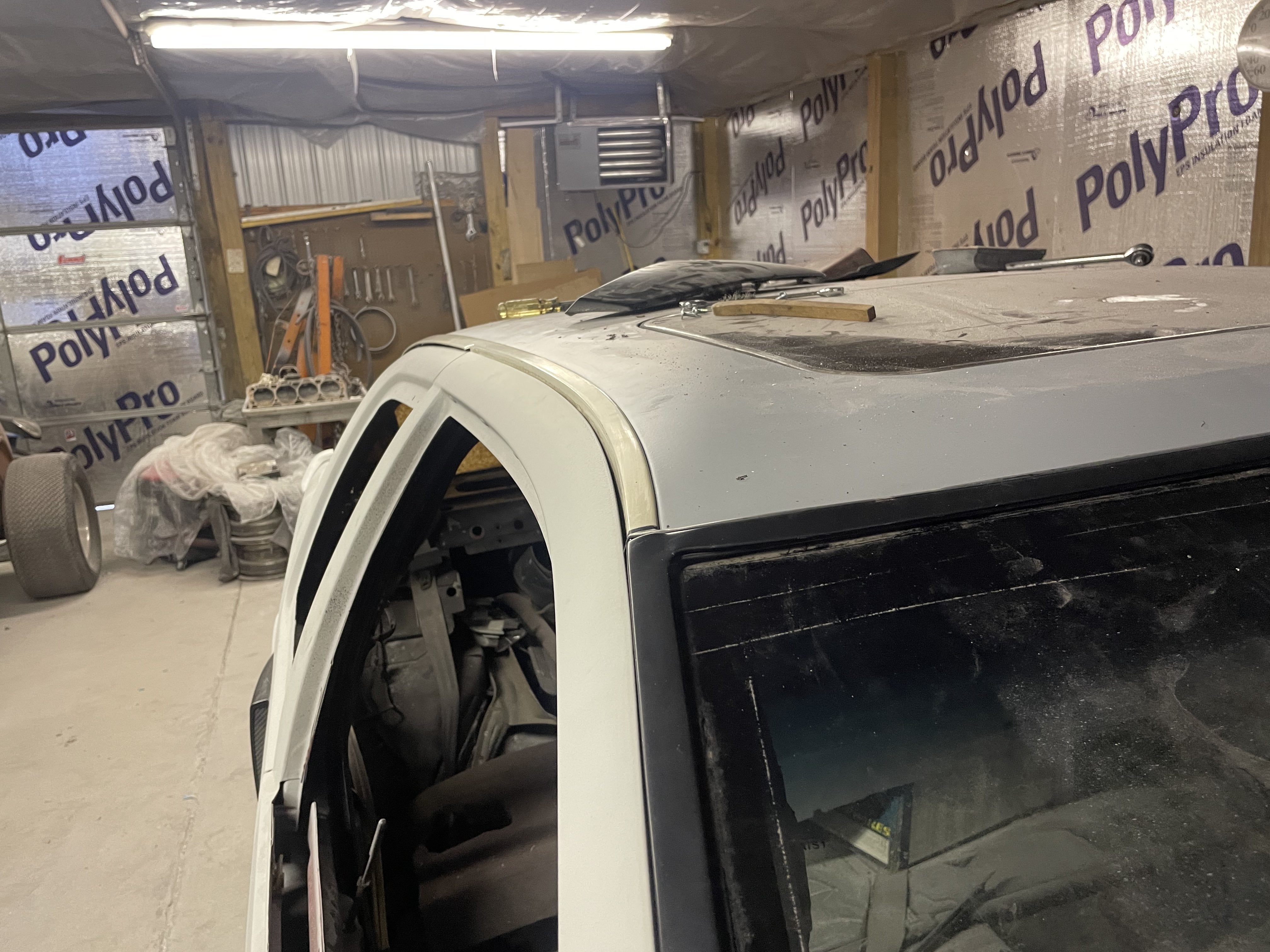

-We also converted to the 94-97 Cougar style roof moldings which I think are a much cleaner look.

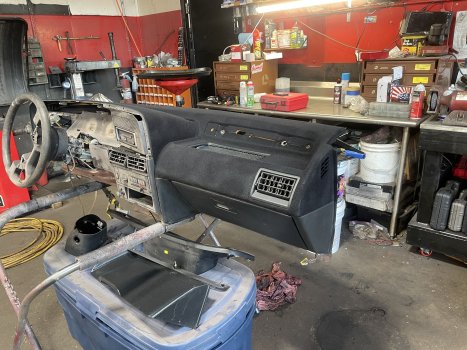

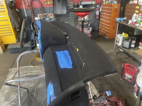

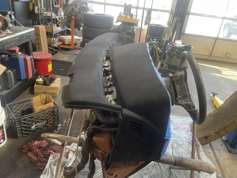

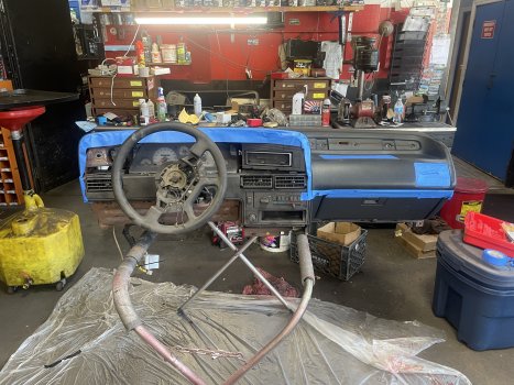

At this point, the custom body work is pretty much done. The only other thing he will have to do is modify the hood, but we can’t do that until the engine is installed so we know how much higher it has to be raised to clear. Once he finishes everything with the body, he is going to spray it in black sealer and give it back to me to re-assemble everything, get it running, and drive it enough to work out all the bugs. Hopefully I can get some driving in on it this summer and fall, and get it back to him in the winter for final paint! Here’s all the pics I have so far.

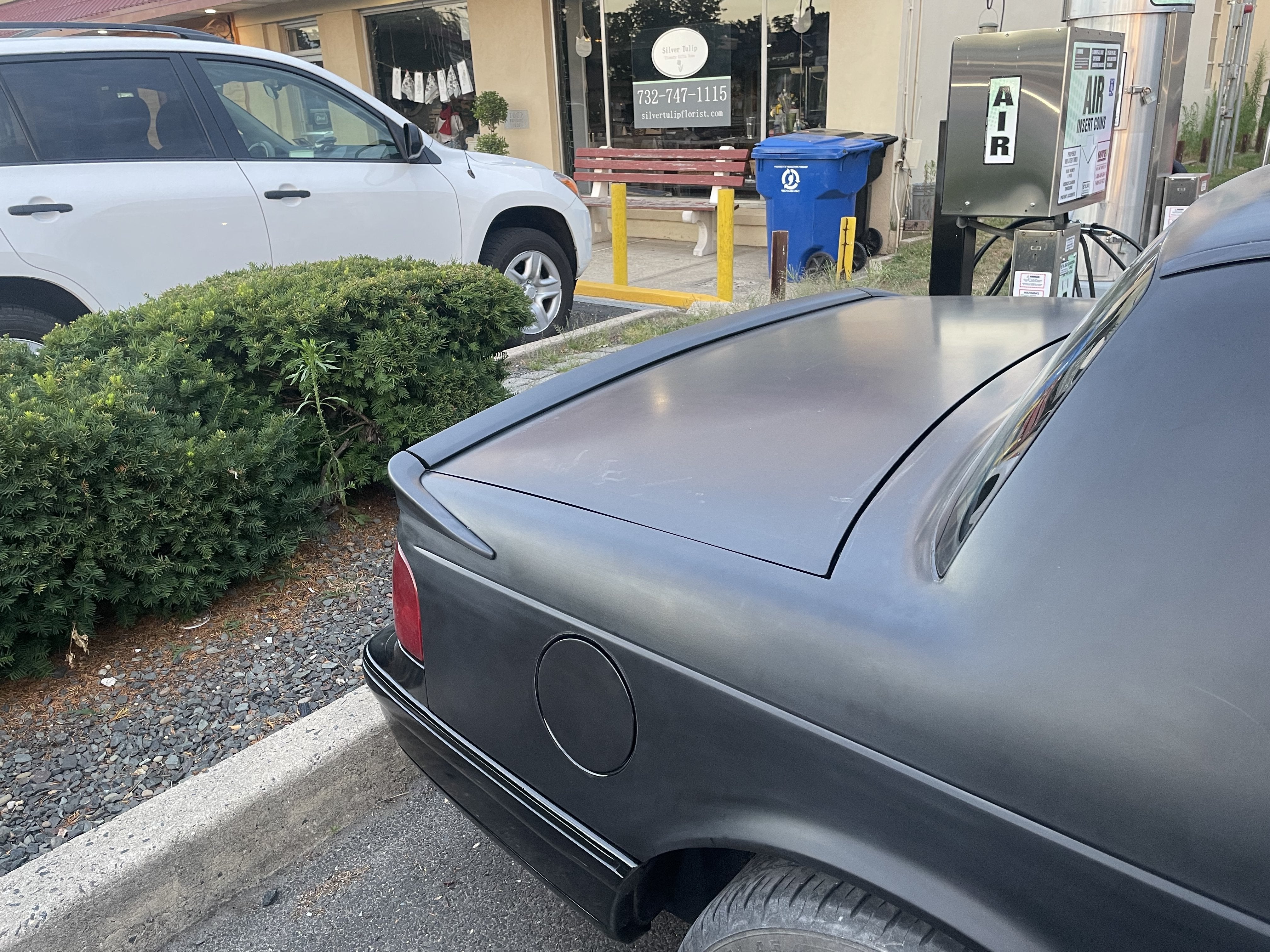

Time for an update on this! I got the car back from the body guy this past week. All the body work is done, the jambs and trim are edged out, and the car was sprayed in flat black sealer. The hood has not been touched yet, other than bolting it on and a cursory gap adjustment, because it is going to have to be modified to clear the engine. At this point, I have to get everything back together on the car, and then the goal is to drive it for a month or 2, work out any bugs, then give it back to him for final paint around November. As it sits right now, the car has no engine, transmission, or interior, and the suspension has to be rebuilt, new brake lines and fuel lines run, and I’m sure a ton of other things that need to be redone. Today’s project though was fixing the dash. The black 90 dash that I pulled out of the car many years ago was crack-free when I put it into storage 8 years ago, but in the meantime developed 2 small cracks, one on the passenger side top by the glove box, and one on the driver’s side by the VIN plate Today’s project was to fix those cracks and flock the dashboard, and I’m quite happy with how it came out!

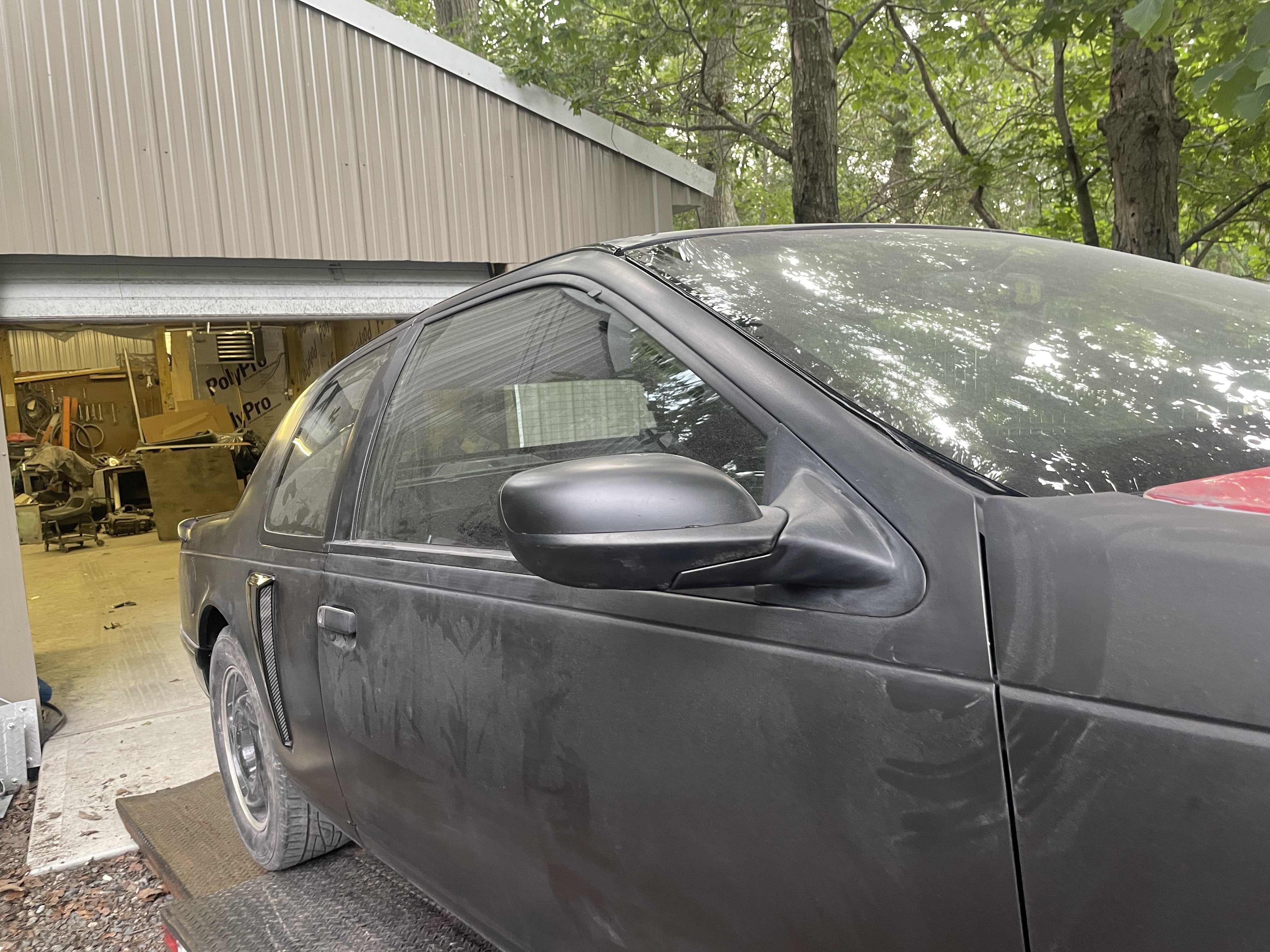

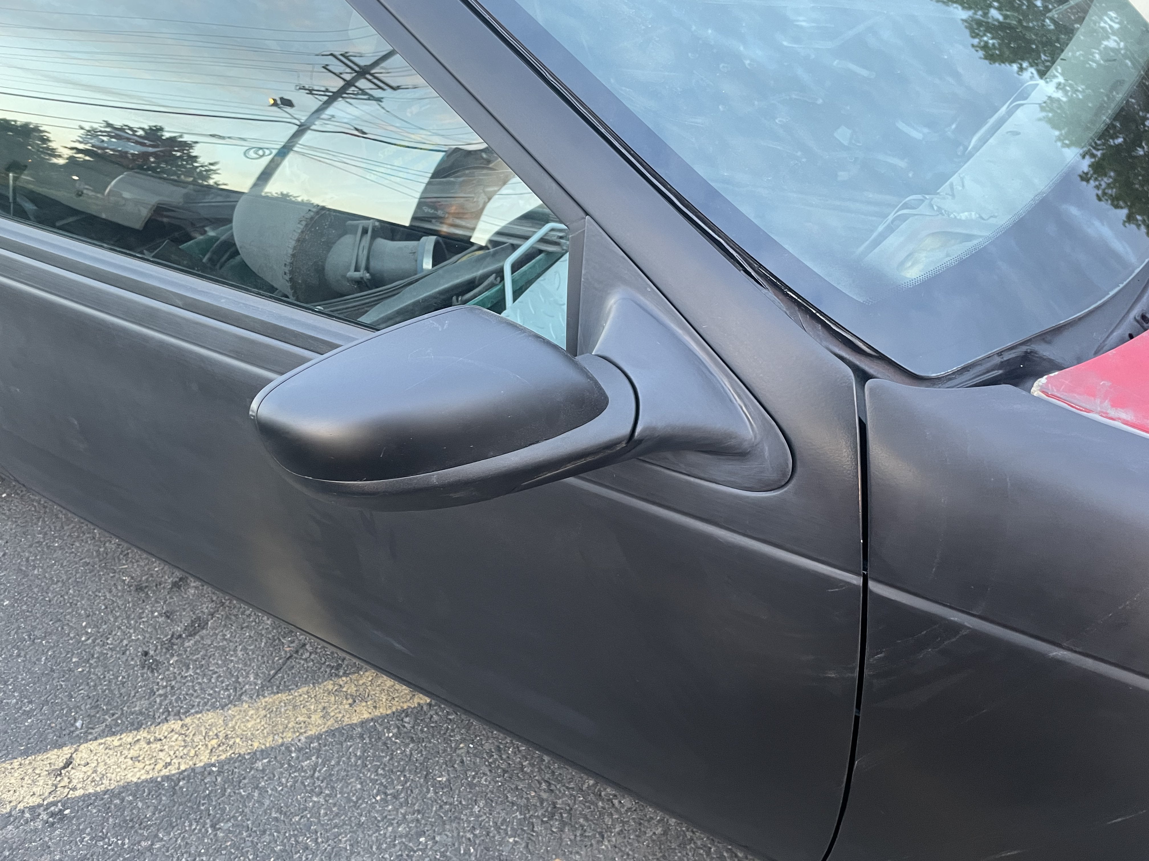

Some more pics of the car as it sits now. I did something a little different with the mirrors to get them away from the body a bit. My main reason for doing this is a functional one (factory mirrors create a low pressure zone that wreaks havoc with the windows at 150+mph) more than an aesthetic one (factory mirrors still look more “right” to me), but I’m pretty happy with the look of it. The flush-mounted rear glass also looks a million times better than the wrinkled and dried up old rubber molding!
dcf5c21e-d7f2-410d-a7ce-64f76ec29f42-jpeg.49796
3f6843ae-ae5f-489e-a428-3debcecbc22b-jpeg.49797
246bb470-1505-4a5f-a145-d84e9067f772-jpeg.49798
55fca319-7f31-4b3f-9185-f0ac5dc028f3-jpeg.49799
19a62536-506d-442d-af25-dc241221a37d-jpeg.49800
4f4e1674-66ac-4c89-8dc0-1db9bd540a50-jpeg.49801
July 11, 2022
The mirrors are off a Mazda RX8. Basically the base of the mirror had to be cut off, then he grafted on the MN12 mirror base plate, and he used some 5/16” threaded rod going through everything that is held into the mirror assembly with panel-bond adhesive, and then the whole thing was plastic-welded then smoothed out with body filler. It was quite a lot of work! The reason the mirrors cause issues at high speed is because there is no air-flow between the mirror and the door, so the mirror creates a low-pressure area on the door glass. Under normal driving conditions, it is a non-issue, but at 150+, it is enough to pull the top back of the door away from the body and make a hellacious wind noise. By having the mirror stand off from the door, hopefully the air-flow will be more laminar across the door and cut down on that effect. This is why supercars have their mirrors poking way the hell out away from the body in the middle of nowhere.
