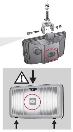

...when adding fog / driving lights and the manufacture says to put lens facing a certain way, follow those instructions.
I installed my driving lights some time ago, but was not sure why they did not seem to light up the street that well. The other day I was going over the Hella manual on how to hook the lamps up to the headlights so power is only going to the lights when the headlights are on. I found something I should have read. Hella says to ensure that the lens of the driving / fog light is with the emblem facing right-side UP. Not upside down. I took the car for a drive that night after changing out the lens and had a noticeable difference in the lighting. (this does not apply to LED lamps)
Even though the lamp emblem is upside down, the lens emblem needs to be right side up.
