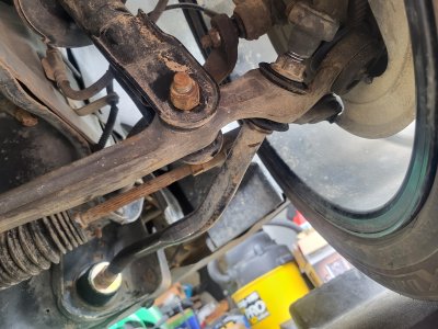

I had the OEM replica rears/ poly front strut rod bushings installed at the shop.. but where in the hell are the washers?
Got the car back, steering feels infinitely better and the binding sensation is gone, but looking underneath I'm curious were
the rears installed correctly..? there aren't any washer holding them and I had forwarded instructions from SCP to them.
That sucks.
I think the bar should be bend-side down…looks sideways.
I really think you need the washers. I would take it back.
I just wasnt even sure if that side needed washers. It looks like the fronts were atleast installed right and it feels better than the aftermarket garbage, but if there has to be washers there i will be going back

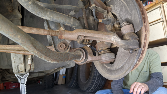

I think it's the angle is weird. Looking at my Dirty Bird, (opposite direction, same area) you can see and compare the two. I would think that his is correctly oriented.
i kind of see what you mean? i assume this would be an alignment or final torque issue? car is going back in monday. I went in after verifying that washers are needed there and lo and behold their techs are holding a box of "extra parts". smh
the good news is these front poly bushings are super beefy, and dont seem to bind up like the aftermarket stuff. Now im just worried about good parts exploding
:bangedbybird
As long as the concave part of the rod is oriented up, should be good to go. Luke’s photo makes it appear that it’s sideways, facing in.

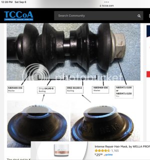

If they use the washers from the mevotech/ aftermarket stuff do they need to be compressing the oem bushings or inversed like the oem cup washers? i Assumed have them reinstall as if they were using aftermarket bushings but all the pictures ive seen show an inverted washer

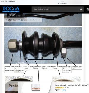

image_2026-03-14_213403317.png should the same be done for the aftermarket washers?

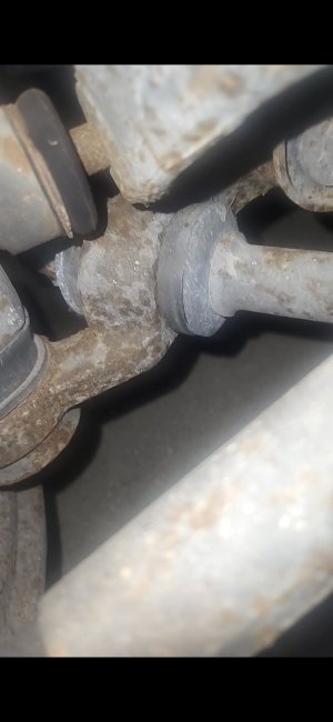

Here is what I mean though. Pic from the cougar that is in the process of being sold The washers they have are the same style as these, but now that I'm on oem bushings again in the rear and the oem washers are long gone.. can they just invert the moog style washers so they aren't pinching the bushings?
Never get rid of any factory washers.
I had to source a set when I did the koni's.
You can't buy a washer like the one on top of the front shock.

well tbsc has the washers i need for 5$ a pop, but the car is going back into the shop monday and all i have is the moog ones so if they would work inverted i would use them for now
I'm sure they will be fine, as long as they torque against the bushing and are wider than the hole, they are doing what they are meant to do.
alright i just didnt want to throw them on as if i was using the moog bushings still, ill have them installed inverted then.
i might still order 4 of the oem washers just incase this fails. 3 year warranty on the scp bushings but idk if that will still hold up with improper installation being documented
Actually i apologize im losing my mind here. Even the "inverted" washers still cup the bushing on the shallow side. so i will install them conventionally and have them run the full range of suspension to make sure they arent binding
