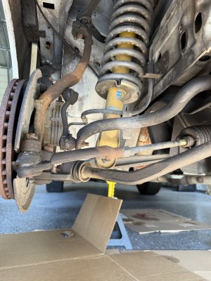

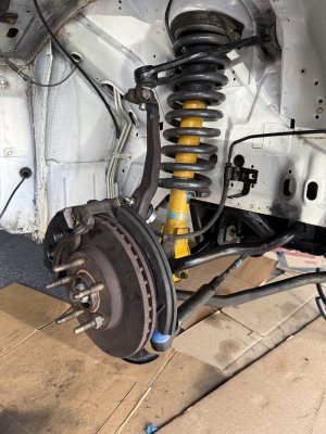

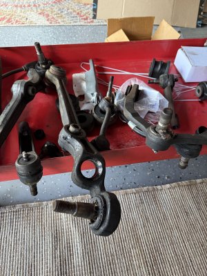

Now that I've been under the car, I can see that all the bushing just about everywhere are toast. I've been reading suspension forum and will post there. I need to search a bit more and do some homework before I ask for help. I'm worried I can't find the parts anymore.
I did drain the trans and fluid was nice and red. I think I'll just drop the pan, clean it up and refill. Save the TC for another time.
The rear end link bushings actually disintegrated while I was working. I thought dirt had fallen on the floor.

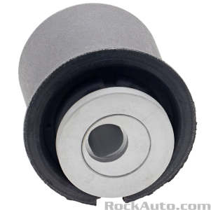

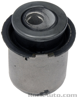

Are the correct rear upper bushings still hard to find? I remember a few years back they were being made incorrectly by a few companies. Wondering if I need to replace mine because just by looking the Cougar seems to have more rear camber than I remember :unsure:
This is the picture of Mevotech MK8562 at rockauto and it looks like the correct style-
The picture of the Dorman looks wrong-
The Mark and the T-bird do have "different" LCAs and UCAs (the LCA has a different K-member bushing and the UCA for the Marks has a boss added for the air suspension sensor) but otherwise they are interchangeable.
I recall it was a "luck of the draw" situation regarding finding the correct rear UCA inner bushings. Ordering two of the same part may yield one of the right part, and one of the wrong part. :(
Are the correct rear upper bushings still hard to find? I remember a few years back they were being made incorrectly and hard to find.
This is the picture of Mevotech MK8562 at rockauto and it looks like the correct style.
As I understand it from posts over at TCCOA, the issue was that a bad design had made its way into the supply channel seemingly at random, so that even people buying what they thought would be the correct design were still sometimes getting the wrong version. As such, having the correct picture shown isn't a guarantee that your particular order is going to come out right. As far as I know, only Bill at SCP is both a seller of those parts and aware of the issue, so that he checks to make sure they're the right ones before shipping.
I bought a set of the Dormans BC851536PR about a year or so ago and they were correct. Hopefully most of the garbage is out of the system, but who knows.
I hope so! Those bad ones came into the market out of nowhere and literally cannot work unless you just throw them on without a care, which literally nobody who’d be able to who’d find a bad rear UCA bushing is bad to begin with would do!
