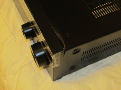

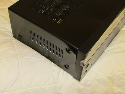

    I did buy a new one from Amazon later and it came in a Sony box. Styrofoam protection and all. I pretty much go to Etsy now when I am looking for something.
