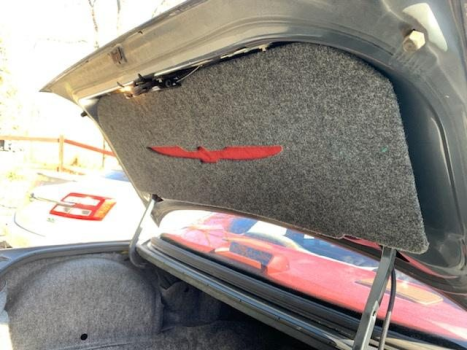

Love the trunk liner
A friend made the trunk liner for me while he was a member of the Foxbody Club of Connecticut. He's since moved to Florida but I can put you in contact with him if you want one of your own.

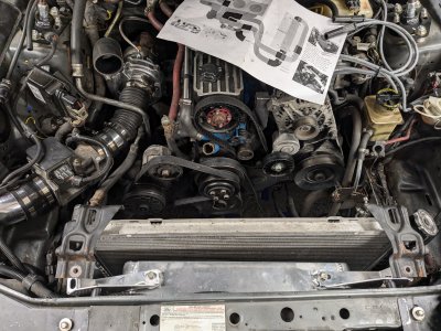

That tiny ihi is going on the shelf, fmic being installed, and installed the an adjustable FPR to cover my lack of a tunable computer.

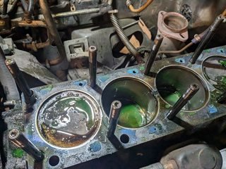

Ignore the coolant, cylinder 2 & 3 were discussing plans.
Head is back on with new head gasket. New turbo in place and exhaust is connected. IC is mounted up front. Now just to find the time to plumb. Also going to add a cooler for the power steering since the power steering fluid was the worst smell like a burnt up automatic transmission.

I've made a little progress. Trying to figure out the FMIC Tubes around the A/C lines now.
here's a picture
