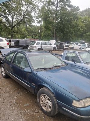

Mine looks like this:
Do your all's sit higher up?
Also, that white plastic piece there, apparantly it should be screwed to the sheet metal? Mine is loose. What type/size bolt is that? I forgot to check when I was at the junkyard.
That reminds me; I need to tell Habbe to bolt his back in; it never got bolted in after I replaced it, lol
I think there are two, and I fairly sure they're 8mm heads
It being a 1997, that's a good sign it's been replaced. You might want to look and see what the original catch code is on that eec, but it's unlikely to match the sticker on the pass fender, at the hood gasket. FTE1 was one of the more common fails.
I'm reading the workshop manual: removal/installation of the PCM. It pictures the white plastic bracket and two bolts; however, for removal it just says to pull the PCM downward. No mention of removing the bolts.
So...I guess it's supposed to be loose?!
I'll look at it tomorrow.
Technically I think you're supposed to be able to push the PCM towards the firewall and it'll drop down past the bracket, but in practice it fights you like hell because the bulky harness is resisting your effort, I always unbolt the bottom bolt of the bracket instead.
It's not supposed to be loose either, someone for whatever reason accessed your PCM for something in your cars past.
