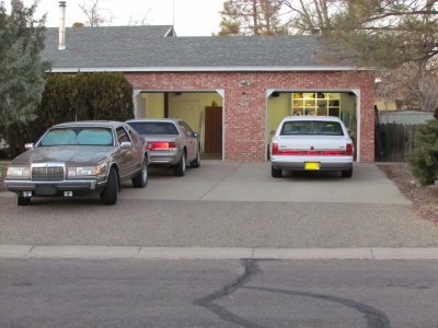

    Is this an excellent collection of Fords or what? I miss my Mark...sometimes. But something had to go.
