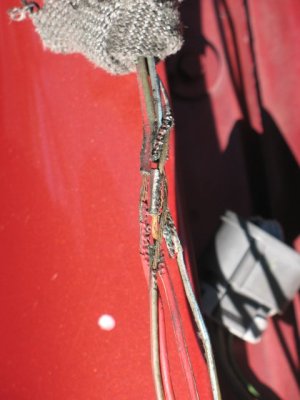

Over 15 years ago I recall having had a code for both front O2 heater circuits. After hours testing and troubleshooting the harness in various locations, I eventually found the issue was in the harness to the upstream passenger O2 sensor... hopefully this is not your problem!
