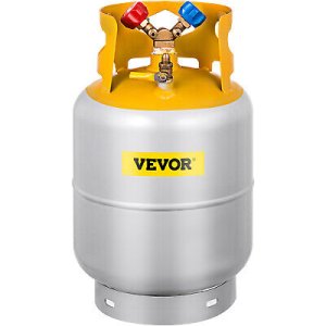

If you would, please explain in a bit more detail. I haven't ever done anything similar to this and I have no idea what you are trying to tell me. I have bled brakes before using vacuum but that's about it. I DO however have a very old propane tank that is structurally sound. It even has a gauge on it that shows how full it is. It's the only one I've ever seen like it.
.. something like this. The Y fitting has ports for the high and low pressure. The siphon tube extends down into the tank. ( what is the purpose of the siphon tube .. 🤔 ? ) .. that's another story.
An old propane tank may still have internal corrosion; it's condition is unknown until you look inside. Not recommended IMO but people on this forum tend to do things outside of the box on occasion.
Not trying to get too long winded here; your question was about needing expensive equipment to recover refrigerant - and while that is true for the most part especially on the professional end, I mentioned that there are other methods for the responsible recovery of refrigerant. 36 oz is not much - they'll never know. 🤫 I lost about 120 pounds to the atmosphere from a system at a jobsite last year - there was a defect that developed in a Brazed joint inside the condensor unit and it all leaked out after 1 year.
