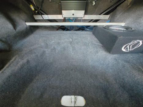

My solution that year was a sealed 8" Kicker CompVT 09TCVT84 loaded enclosure that I bought around the same time as a JL Audio XD700/5 5-channel amp to replace my 4-channel Directed Electronics 500. The thinner part of the Kicker enclosure slid underneath the brace, with just enough sliding under to not block the spare tire well. It was much better than no sub, but I had to push it pretty hard, and I never thought the bass was truly immersive. It usually got the job done for rock and metal, but was always kind of underwhelming for the rest of my library which includes EDM, hip hop, and pop. It had some punch but lacked extension.
To make things worse, I had the sub pointing upward, which is the worst position to place a sub in a trunk because of wave cancellation. It was significantly louder with the trunk open versus closed. Sure, I could have put the sub in front of the brace and aimed it at the back seat, but that would only fit horizontally and block the amp. I always figured that I would at least need a second 09TCVT84 one day if not something more substantial. Having just one back there was always a temporary solution.

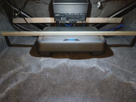

Fitment of this thing was always going to be tight, but this was a total shot in the dark. The dimensions of the enclosure are 18.5"W x 4.5"H x 12.5"D. I had approximately 4.375-4.5" of clearance under the brace. The carpet and the padding/sound damping material underneath made the exact measurement imprecise. The worst case scenario was that I would need to fully remove the brace and shim it to gain the clearance I needed.
I first tried sliding the sub in straight under, which didn't work. I needed about another 1/16-1/8" of clearance. I was convinced that I would need to loosen the brace, slide the sub underneath, and re-tighten the brace. Then I tried sliding it in from the right side where the Kicker used to be. That was a pleasant surprise because not only did it clear, it didn't touch the bar. The padding under the carpet doesn't reach the edge of the trunk. I could now slide it in from the side and then push it towards the middle, where it would compress the padding and be securely wedged underneath the brace.

I was content with the output at first. It was definitely louder and deeper than my old Kicker, which I mentioned here. However, I also installed new Alpine R-S68 speakers in the doors at the same time, so I had a lot of re-tuning to do on the amp.
After tuning and even before I've received and installed new RCAs to feed the sub a signal from my Pioneer Premier DEH-P800PRS head unit's subwoofer pre-outs rather than the amp's speaker-level signal, it turns out this Alpine has a lot more output and headroom than the Kicker in their respective trunk positions. Anyway, once I gain additional tuning control for the SS-SB10 at the head unit, I should be set for good.
I decided not to use the good old "Bass I Love You" by Bassotronics or "Bass...Can U Hear Me?" by Beat Dominator as test tracks like I've done for subs inside the house. I tuned against "Narco" by Blasterjaxx and Timmy Trumpet since that was a better point of reference against the system in my Lexus GS 400. That wasn't hard to match since the JL Audio XD700/5's dedicated sub channel supplies the SS-SB10 with 300W at 2-ohm compared to the 150W at 4-ohm to a 10" Kicker CompC on the bridged rear channels of the Kenwood Excelon X302-4 amp in that car.
I've gone from content to very pleased after some basic tuning and I haven't even had a chance to bring the head unit's EQ into the mix yet. The Thunderbird finally has the unequivocal best-sounding stereo in my garage. Out of all my options for a new sub, this Alpine might not be the best performer for the money, but for its minimal height and downfiring position, it was in a class of its own. It also finally let me use the brace as a feature of the subwoofer rather than an obstacle to it.

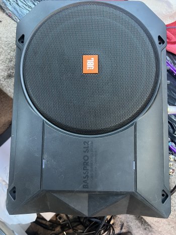

My younger son and I are installing a JBL powered sub that is similar to that. 10" speaker. We tried it out and it really did a nice job. I'm sure the Alpine is quite nice.
Nice, do you know what model it is? I wasn't shopping for powered subs, but I wonder if I might have come across it at some point. I'm pretty sure I shopped the heck out of everything available under 5.5" tall and thinking it could work with some finagling!

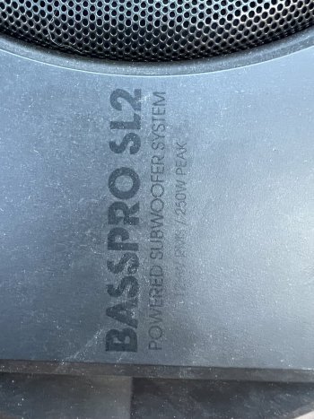

JBL Bass Pro SL2

The JBL 10 sounds nice enough to know the difference when we turned it on and off. We are not going for Volume persay. Just fidelity overall. I'm sure there are "Better" options. But it does sound good. We are running an Alpine deck that is 10 years old or so now. JL audio speakers, and a 4 channel Alphasonic amp. Everything isn't fully installed quite yet. But we are getting there.
