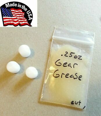

For repairing the motors, all I needed were the three pins and grease. The gear in both of mine looked fine.

I think I'm just needing the gear and the buttons, at least that's what I ordered.
"73 ford Torino" Those three pucks and gear have been in production for 50+ years...

Well, I have the window motor out now and disassembled. I'll be damned if I can get those 3 pucks back in to place. Tried using a hose clamp to hold them in place and press them in. Nope. Couldn't quite the screw of the clamp to sit inside the window housing so that was a fail? How is it SUPPOSED to be done?
Hey, i just read your post about the alignment shop and feel your pain, they often don't know and don't take pride in their work. However, hopefully i can be a little help as I rebuilt my window motor last summer. You are right in that its tough as hell to get all the buttons in the gear, it is supposed to be that hard, when I did it, I had my dad help hold the "top"? i cant remember what it exactly was but then i aligned all three buttons and when they were all just barely pointing in correctly, I had my dad basically put a ton of pressure straight down to get them all in, and it worked. So try having a helper if possible and get all three kinda lined up with the bottoms ready to go in and then when it gets pushed down they all go in. Hope that helps
They are usually a very snug fit. I cannot recall if I install the large main gear and then press the three little plugs into place or if I stick the plugs into place with grease and then press the large main gear into place. What I do know is I've never been able to install them both into the housing at the same time. It takes a little bit of force, but you shouldn't need a 20 ton press.
Thank you! This worked for me! I put some grease on the buttons to hold them in, then I placed the metal gear thing in the middle, pushing the buttons to the outside while carefully putting it in to my vise. It did indeed take a bunch of pressure and just when I thought the gear might break, I heard a small "pop" and they slid in the rest of the way fairly easily! I appreciate the tip!
