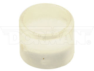

I also had my door apart yesterday for the window motor. The "gear plugs" had turned into mush inside the gears. I don't know how the window was still somewhat working they were so destroyed. I think I replaced them in the past so it's surprising they went bad again. I have heard of people replacing them with hex nuts instead of the plastic plugs, might do that next time it fails.
Here is a link to the plugs...
The ACDELCO kit from RA had the best lube. Using nuts instead of the pucks moves the breakage somewhere else.
I would advice against using anything but the plastic plugs. They are cheap enough and are critical to keep from stripping the gear assembly of the motor gear and gear housing. Just my two cents.

I bought three boxes of the Dorman kit while they were on sale at RockAuto. Only to find out the motor assembly
from RockAuto is NOT for a Cougar / Bird. The whole inside is bigger and much different than the doorman kit, which I am familiar with after replacing them on my Mark VII​
Sorry about the font... I hate copy and paste from search engines... :P
Don't buy this kit either it is the wrong one -
I ended up only using the three plastic plugs, the other parts were the wrong size. I thought they were all the same.
I have three boxes of these if anyone needs one... :P
I have three boxes of these if anyone needs one... :p
At least I wasn't the only one.
I bought the kit because I wanted to replace everything in the motor. I thought maybe I used the wrong grease on it the first time I fixed it, and that caused the plugs to fall apart.
Ended up cleaning it out with brake cleaner, used the plugs and the grease the kit came with.
This is the kit with the good lube now...
