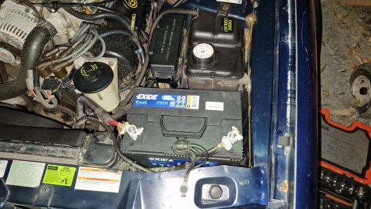

Yeah. It was the physical dimensions of the battery what I wanted to be precisely correct, as I got a remark about the battery being loose on the yearly safety inspection. (The current battery is euro sized and too small for the stock clamps to keep in position). And I wanted to avoid crafting a custom battery holder as well, due to engine bay aesthetics.
Got the "new" battery yesterday. "New" in quotes because the battery had been sitting on the store's shelf for two years, although still seems to have ~12V of voltage left.. So perhaps they've charged it a few times. Gotta charge it with a "smart charger" before installing and see if it's any good or not.

The weather finally went above 10°F, warm enough to install the new battery 😎
It fits like a glove 👍 And seems to start fine at least when the battery is room-temperature warm. It remains to be seen how well it provides current when cold.
And as a side note, I realized the positive cable and its clamp are somewhat corroded, oh well..
