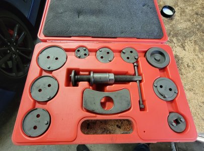

Is a special tool needed to compress the rear caliper pistons?
The crappy auto parts store cube can actually work ok for compressing the pistons if you remount the caliper to the spindle with the rotor off so you have stability.
Does it just have a slit in the middle of the caliper piston instead of the "cup" design?
The caliper piston has 4 "V" shaped cutouts at 12/3/6/9 o'clock that you can use to spin it. Spin clockwise and push forward to retract it. I just bought the kit off Amazon for $20 or whatever it was WBW (looks just like the one Dan listed), used it many times.
I'll have to get myself a kit then.
I could have used such a kit for my Honda as well, but a big ass flathead worked fine for it.

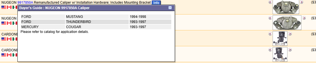

Borrowing this thread for another caliper question:
- Are the calipers on a 1996 Mustang GT the same as the calipers on a stock 1994 (non-sport, front disc + rear drum) Thunderbird? At least they look very similar to me, plug-n-play I hope.
I'd rather go with the PBR upgrade, but no suitable parts available nearby here.
Yes, but some grinding is involved to make them fit IIRC.
