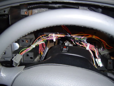

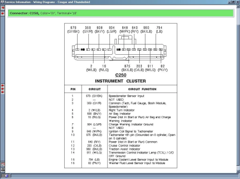

If you're adept at splicing/soldering wires it's not too difficult. Using a supercoupe cluster you'll obviously have to run a vacuum line through the firewall
Here's the pinouts
94-96
97
Here's the pinouts
Excellent, thank you very much.

To be more specifically helpful, I want to know if it will fit without serious surgery to the interior. I expect a decent amount of wiring tomfoolery.
As far as that you just swap the cluster and cluster surround, its a direct swap apart from the connectors being different...
I wired mine both ways with my original dash harness
