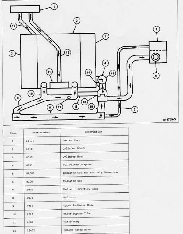

- 1993 Lincoln Mark VIII with a very finicky 4.6L 4V
Would anyone have a diagram for the cooling flow direction on a 93 Mark VIII? My lower hose (under the thermostat housing) is cold and my upper hose (off the radiator into crossover pipe) is warm. Now if the coolant flow is reversed (a la GM LT1) that would be normal, but if not, that would mean my thermostat is stuck, correct?
