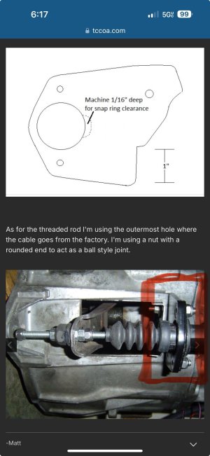

I’d like to start my T45 swap sometime late this month.
I’m looking to see if anyone is interested in machining a bracket for the slave cylinder, I can’t seem to find anyone local, and I could probably do it myself, it wouldn’t be pretty. But I'm trying to cut down on my time to do the swap since I have too many projects going on. Willing to pay! $$
I attached a picture courtesy of XR7-4.6

I can build one. It wouldn’t be exactly like the pic posted, but I’ve made a few over the years. I think I still have a T45 in my garage to use as a template.
That would be awesome! PM me so we can set something up.
Mine wasn’t machined fwiw even that little recess I made for the snap ring to clear I did with a dremel bit in my drill press lol
The shape where it’s squiggly will be a little different for a T45 bellhousing vs a TR3650 which that tracing is based on. The hole geometry will be the same though
Looks like a nice piece for it not being machined!
SendCutSend could laser out the shape. You would have to grind out the clearance for the snap ring clearance. If you can get some better dimensions I could make a quick CAD model for you to send.
