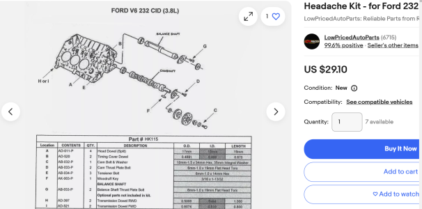

I'm rebuilding an SC engine ('90) and I'm having trouble finding the dowels for the cylinder heads. Rockauto lists this part: Pioneer PF142, but it's not in stock. I'm striking out searching other places as well. I ordered a set for small-block Ford that don't look long enough (https://www.amazon.com/dp/B01MSM1KIO?ref=ppx_yo2ov_dt_b_fed_asin_title).
Anybody know of an equivalent part? According to Rockauto, the same dowel pins are used in everything Ford from the 70s into the 2000s.
i did a little digging and there apparently is a headache kit that includes these with other hardware on ebay. it shows the size to be vey similar to what goes in a 4.6/5.4l modular motor. here is a snapshot of kit. The modular motor dowels are part #F8AZ-6A008-AA which are available at fordpartsgiant.
