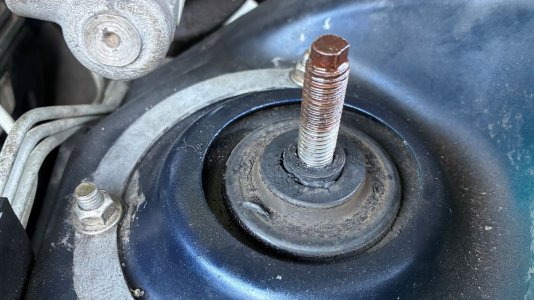

While investigating front squeaks I found on the drivers side; the shock washer / nut on the top that bolts to the shock mount moves quite a bit up & down. Like the mount moves with the car, but the top of the shock moves independently.
How concerned should I be?

I had to put a spacer under my shock nut, but it's not "for" an MN12. It did move like you described, so maybe you need to add a washer or spacer? You can check that without even jacking the car up.
Same thing happened to mine, I stuck a 1/8”washer with a hole bigger than the sleeve under the stock washer and it’s been fine ever since

I don't think a washer is going to solve this one. I need to replace the shock mount.

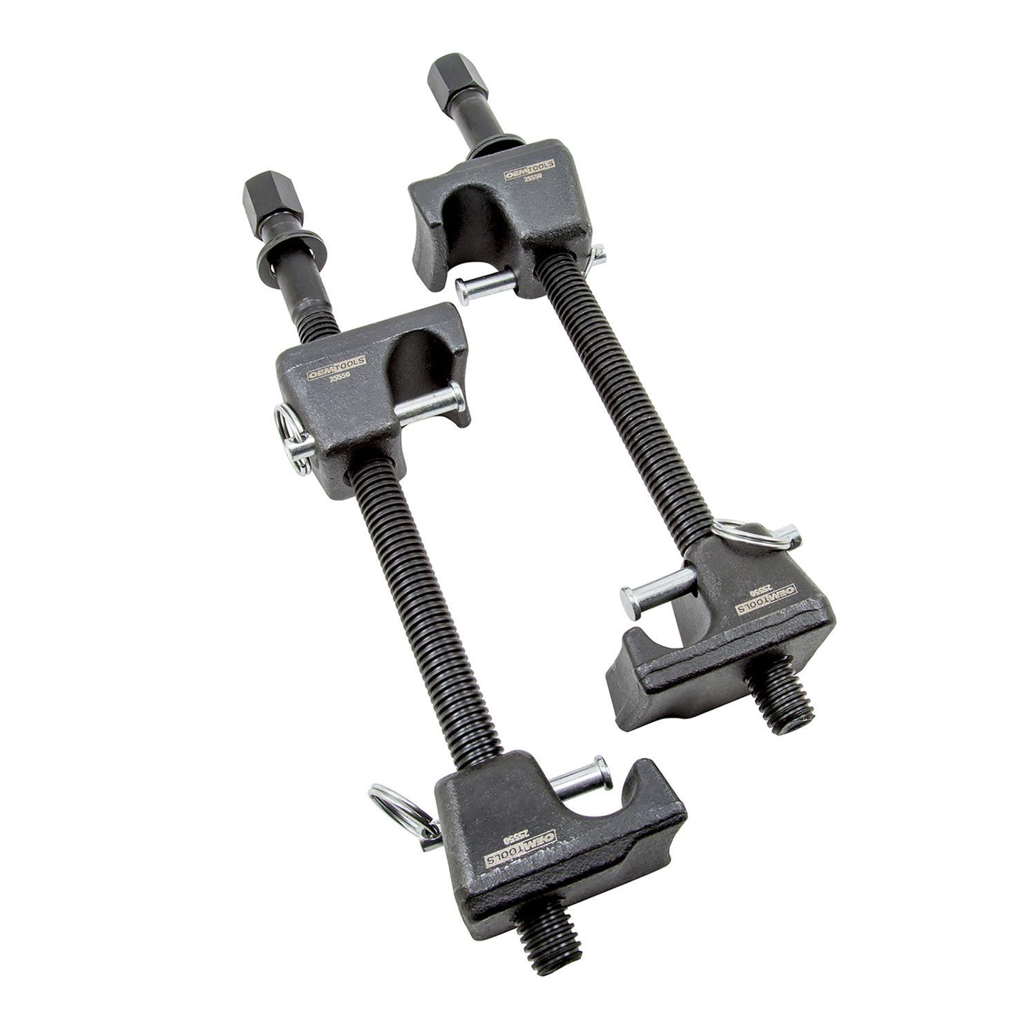

Do ya’ll think either of these are worth the purchase?
They way I see it, it would depend on whether you can find a shop who will assemble them for you for a modest price, and whether you anticipate the need to use it enough to offset the price of having someone else put them together for you long-term.
Worth it may not have been the best question.
More detailed questions are: is the price reasonable? Will it work for our shocks? And is it safe enough to use?
To our terminator's point this is the only vehicle I own that uses coil overs. I've had the car for about 6 years and this will be the third time replacing the shock mounts. I vaguely remember it costing ~&100 ea last time; that's with me removing the shock and dropping it off to the shop. Plus most shops around here are not open on weekends, at least the ones I deal with and trust.

That's so much safer than the compressors I used. That is the correct tool.
